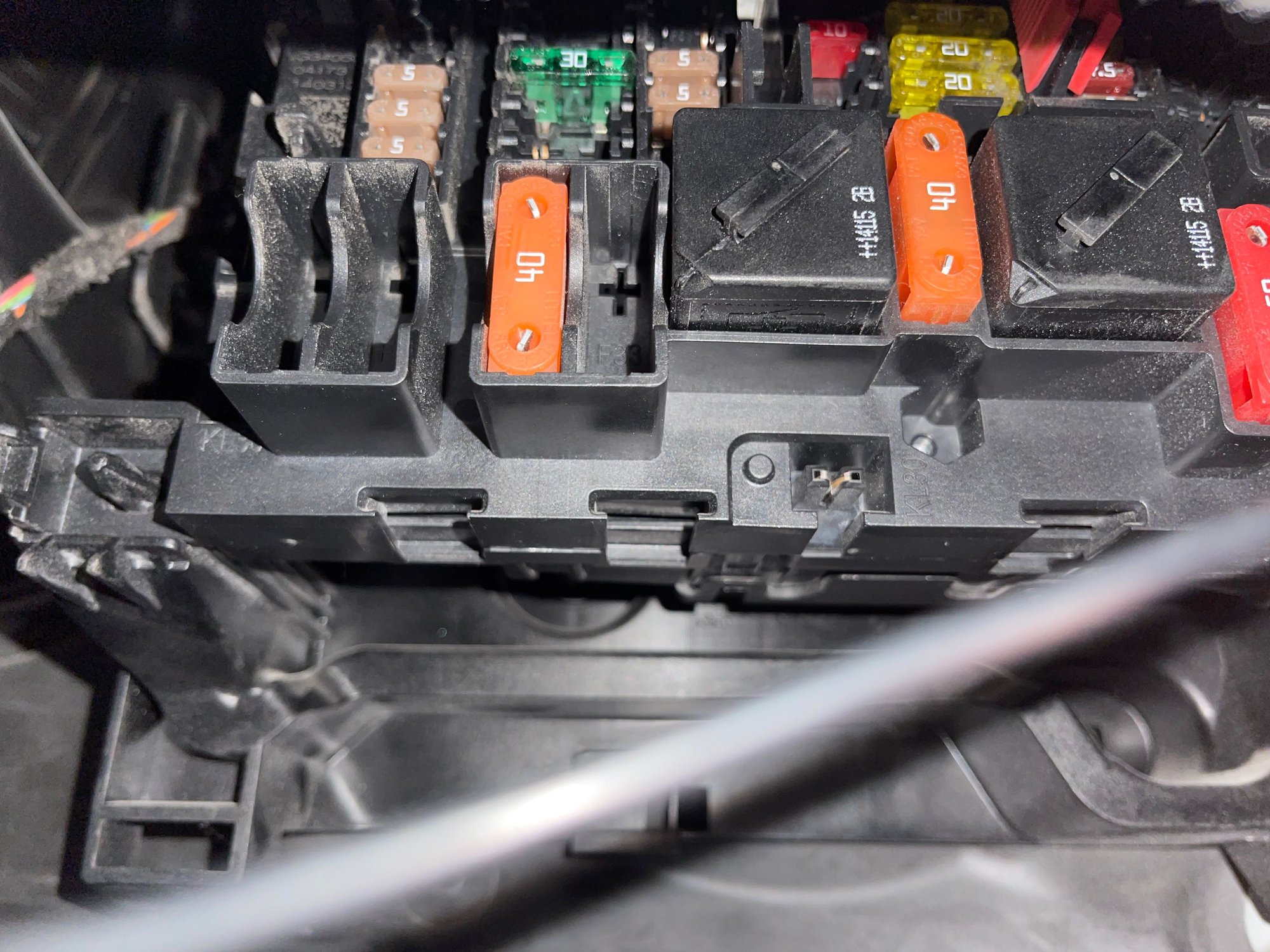

Hey guys,
i saw here https://www.northamericanmotoring.com/forums/f55-f56-hatch-talk-2014/276137-fuse-box.html a picture of a fuse box diagram, and notice fuses 97-132 which are the bottom line of fuses.
however, I looked today at my fuse box and it’s missing this row of fuses.
I just don’t have this specific row of fuses, does someone know where they might be located?

Those are extras with no contacts (storage for fuses). Some options on a MINI are not used dependent on trim level. Those have contacts but no fuse in place.
Unless something is not working or you have a problem, it should be ok.

All working fine, just wanted to add-a-tap to fuse 102 because I read online it is a permanent one.
Currently looking for an other one.

https://www.northamericanmotoring.co...l#&gid=1&pid=4
Scroll down to fuse box pic.
I used an add-a circuit for my lights where there was no fuse, just a one side power fuse slot.
Those 5 slots only feed ignition power from the right so put your add-a circuit in
the right way!!

how did you get this access to the fusebox? It’s so hard to reach it!
Remove the glove box, pretty easy.
The easier option is to release and drop the fuse box.
Even easier
