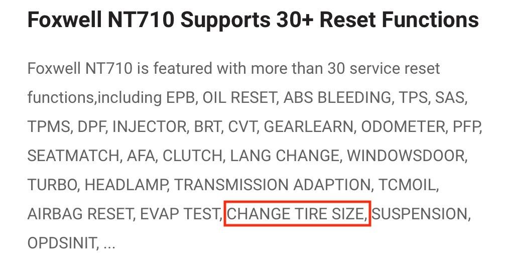

Did you check your brand Spanky new Foxwell NT710??
Thought I saw "change tire size" in its description page.

I haven't had the chance to dig into the Foxwell yet and didn't think of it because it says it has no coding functionality -- but that's coding I guess! Huh! Will go look -- thank you!

@cjv2 bust out the NT710 my friend because it will allow you to change the tire size
@TVPostSound for the assist -Rich

Sooooo I think that bit may be "if available for your vehicle." I just had my NT710 plugged in and couldn't find a single reference to "tire" much less "tire size."
Anybody actually found it in there beyond the best-case-scenario capabilities of an NT710?
