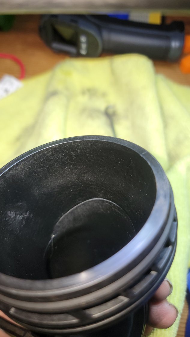

Found a couple of rough spots on and in the turbo inlet elbow. Pics attached. Along the seam at both ends it looks to be separating but I'm not sure. Cleaned the seals up and noticed gaps in the joints.
Thats what I need the opinion on. Does this look likeni need to replace it?

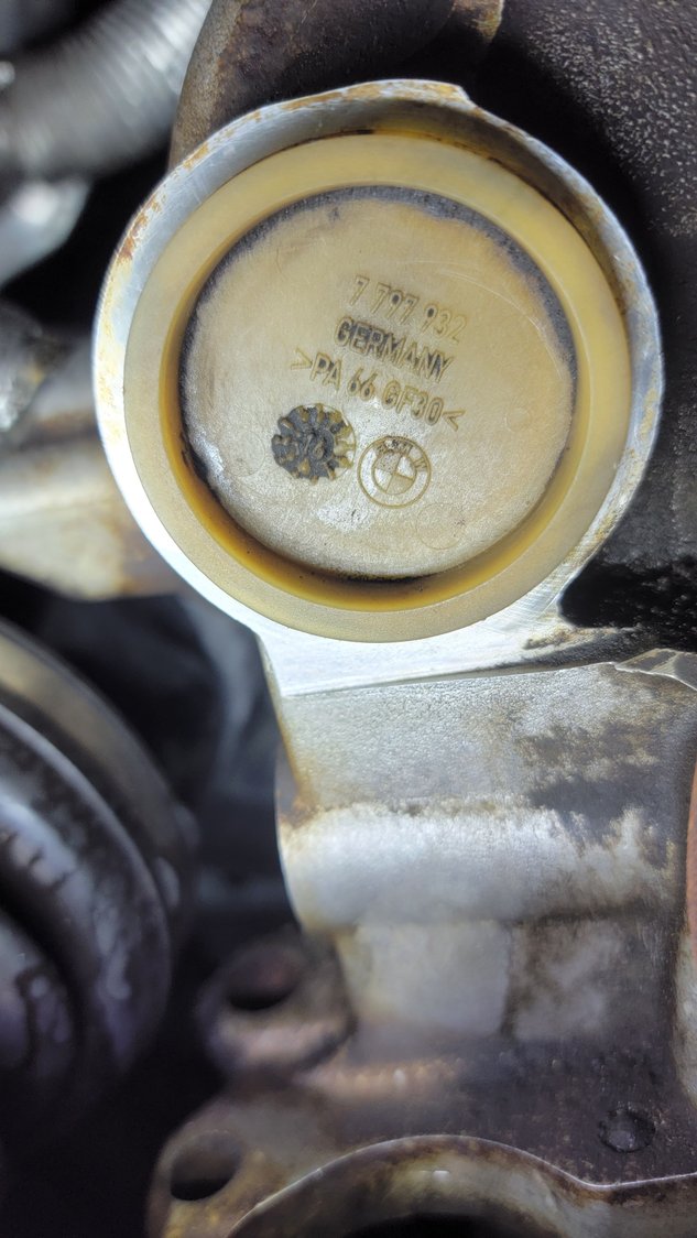

Second is part identification. On each side of the lowest pulley are what look to be small round plugs. The one towards the front of the motor is dry.
On the left is wet at the edge so makes me feel there is water behind it. I can spin both either direction so I stopped messing with them as precaution.
Are they freeze plugs? Because I failed to explain to google what I needed even with pics from my phone.
will attach photos of unknown. Thanks in advance.

https://www.ecstuning.com/b-genuine-...t/11117797932/
Part of the pulley.
Check for the 7 or 11 digit part number and place it into our site.
https://www.realoem.com/bmw/enUS/sho...diagId=51_3781
https://www.ecstuning.com/Search/Sit...h/11655A023A3/
Diagram : https://www.realoem.com/bmw/enUS/sho...diagId=11_5510

Thanks I appreciate it. Definitely a huge help what and where to look. I looked at the oil inlet but not in a suspect way. That may be the culprit.
