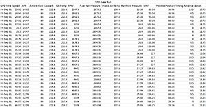

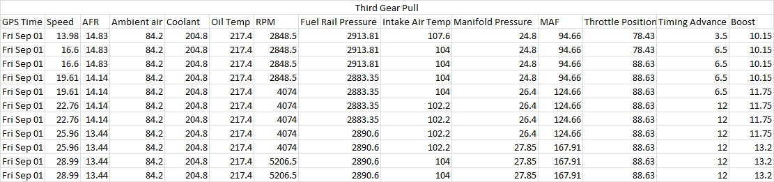

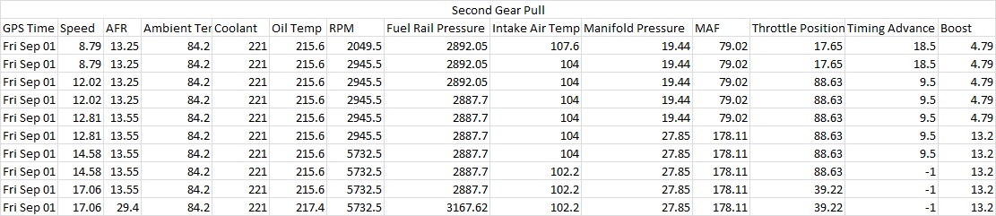

Out of curiosity, pulled using Torque Pro, I need to set the rate faster...
2017 MC JCW 2 DR - Stock
Each pull up to fourth was on a deserted road. I didn't do first gear, sample rate isn't fast enough to catch it, yet. I tried to start at 2k RPM's and a fairly quick roll on to WOT. Fifth gear had to be done on the highway. The fifth gear run I'm not real sure was captured, so the fifth gear on the sheet might just be fourth And there isn't enough room to run uninterupted to get sixth.
Attached Thumbnails Boost pressure-second-gear.jpg   Boost pressure-third-gear.jpg   Boost pressure-fourth-gear.jpg   Boost pressure-fifth-gear.jpg
