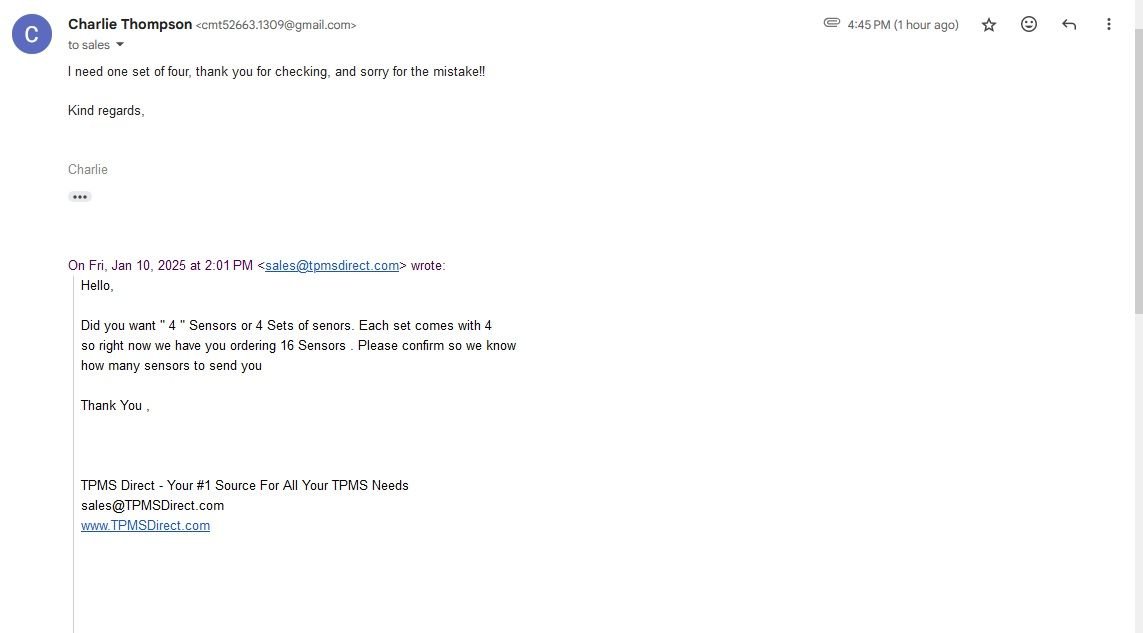

So, what does everyone do with TPMS sensors? Mini of Peabody needs $942.48 to replace four, which reflects the OEM parts price, which is oddly VERY high indeed.
I assume most folks balk at that and seek an alternative, but technology is sometimes finicky so I wonder if aftermarket alternatives work.
I reckon I shall find out.
I went to the InterWebs, and found Pelican Parts and TPMS Direct as potential sources with prices only a fraction of the OEM part. So I grabbed four from TPMS Direct. noting their catalog lists these as equivalent to the 2018 JCW Hardtop F56 - 36 10 6 881 890.
Then I got a polite note from the sales folks at TPMS direct - read, laugh, be amazed, and be skeptical.
So we'll see if a credit hits my account. When it does I shall have four TPMS sensors for $75, as opposed to $160 for each (OEM). But will they work??
Come April when the DWS 06+ current tires come off, then we'll find out.
Worth a shot I reckon given the price difference.

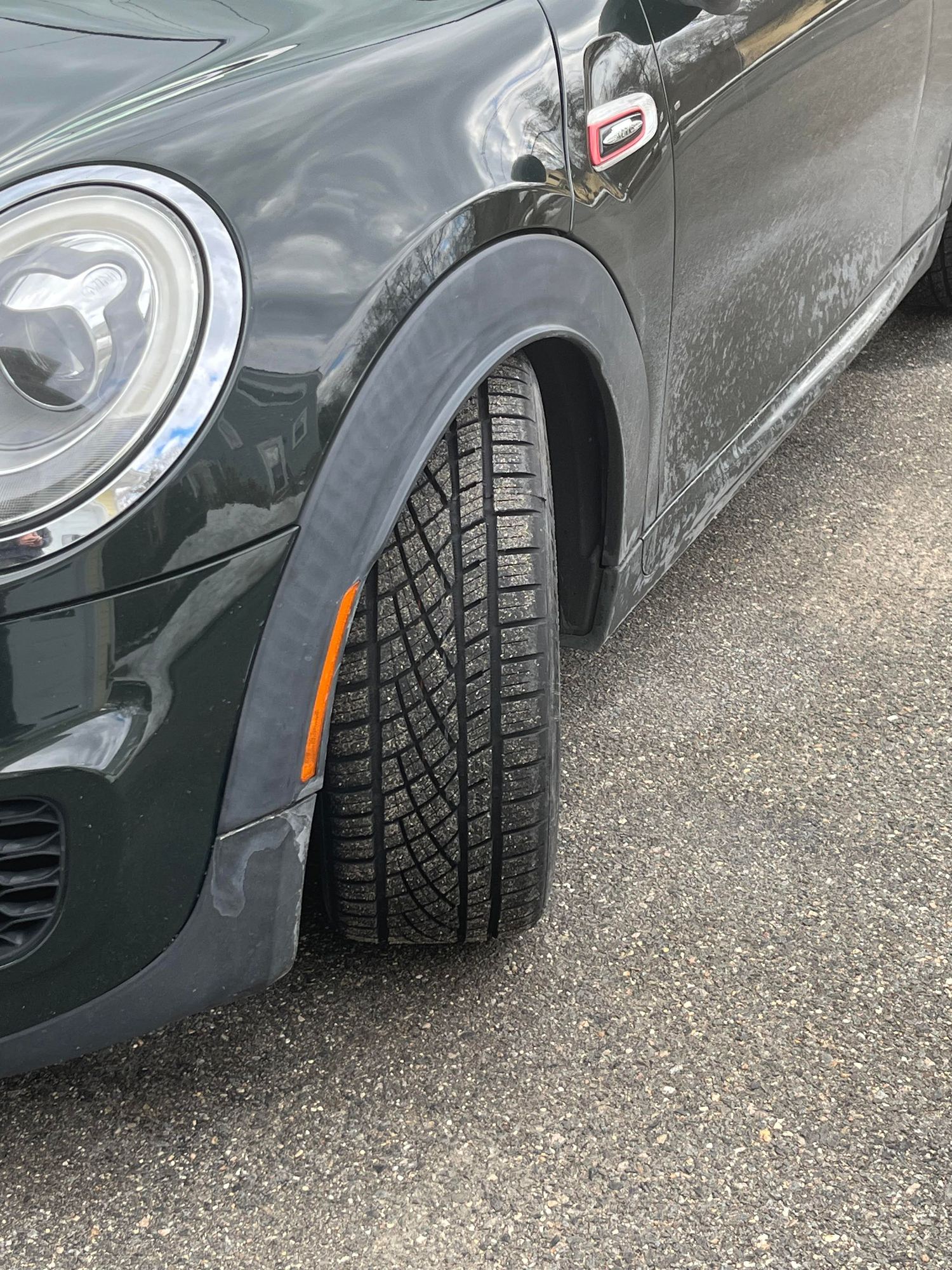

So the TPMS Direct sensors just went on the car without any problems - kudos! That's a massive savings and a solved problem. I now have TPMS again, and can resume watching the effect of speed, weather, and general stress on tire pressures - an endless fascination to my tiny brain.
I have (pause for reflection, and a tear) admitted to myself that Gollum and I are not racing any more (more on that shortly).
Consequently, when the current winter tires which I've enjoyed and appreciated for three years now got a bit too worn for safety in the wet, I did NOT go back to the Falken RT660s that I've run the last two years.
Instead I decided to rely on the Continental DWS 06+ in the same size (225/45-17) that I'd used in the Falken, a bit wider than the 215s I've been running.
They've 8.9" of section width, which is damned close to the 9" of the Falken, but as expected they clear all around, and once more Gollum is looking a bit like a Saint Bernard puppy!
