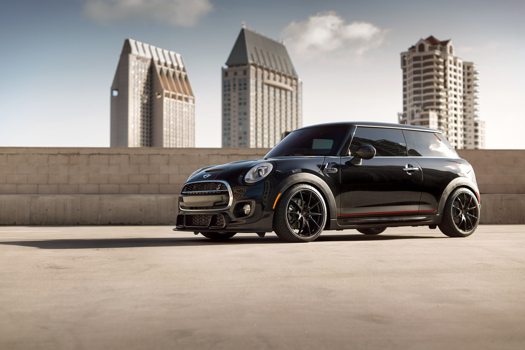

Dont have my specs in front of me, but I am not slammed or rubbing. Here is what is weird though, and not sure if maybe I am misunderstanding something, but when I set the car to sport mode, the suspension definitely feels stiffer --- which I didnt think it would since I have the JCW Coilovers and the DDC is unplugged. But I love the setup regardless, just thought that was odd.
Here are some pics:

Old Jun 9, 2016 | 10:20 AM
honderpilot's Avatar
honderpilot
Joined: Jun 2014
Posts: 654
That's looks fantastic. Can't wait to see the pics on my computer, my phone doesn't do it justice. If you figure out how many threads you have left front/back let me know.

Don't know how I missed these pictures before .. but wow .. that's absolutely gorgeous - amazing pictures as well.

Looks great! What are the wheels?

Volk G25s
