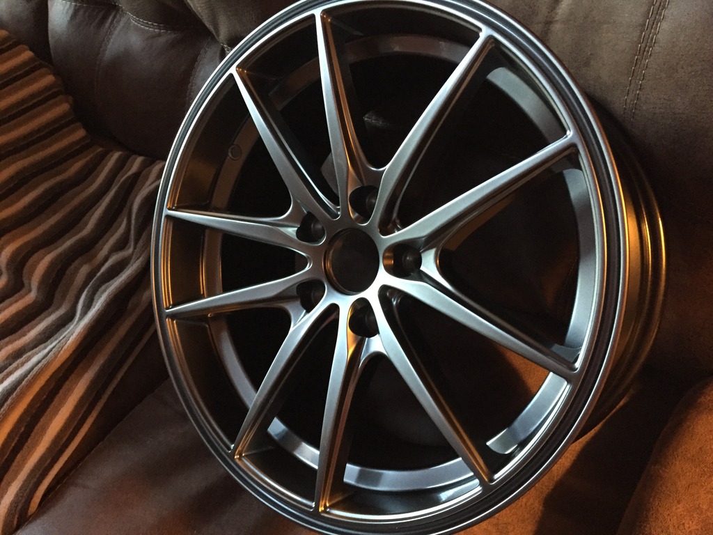

Like everyone has said... there is not a lot to choose from relative to the 1st and 2nd Gen cars. My first choice that I searched high and low for were Rota RB wheels. But, the best info I've been able to find is they won't be made in 5X112 because the inherent design doesn't lend itself to a five bolt wheel. I finally settled on these Koenig Oversteer wheels in 17X8 et45. I have 215/45X17 Goodyear summer tires on them. The wheels are 5-6 pounds per wheel lighter than the Tentacle Spokes I had on the car. IIRC I paid ~$150 each for these wheels. If I weren't planning to upgrade the brakes I would be perfectly happy with these wheels. I like the looks and weight, and the price can't be beat.
