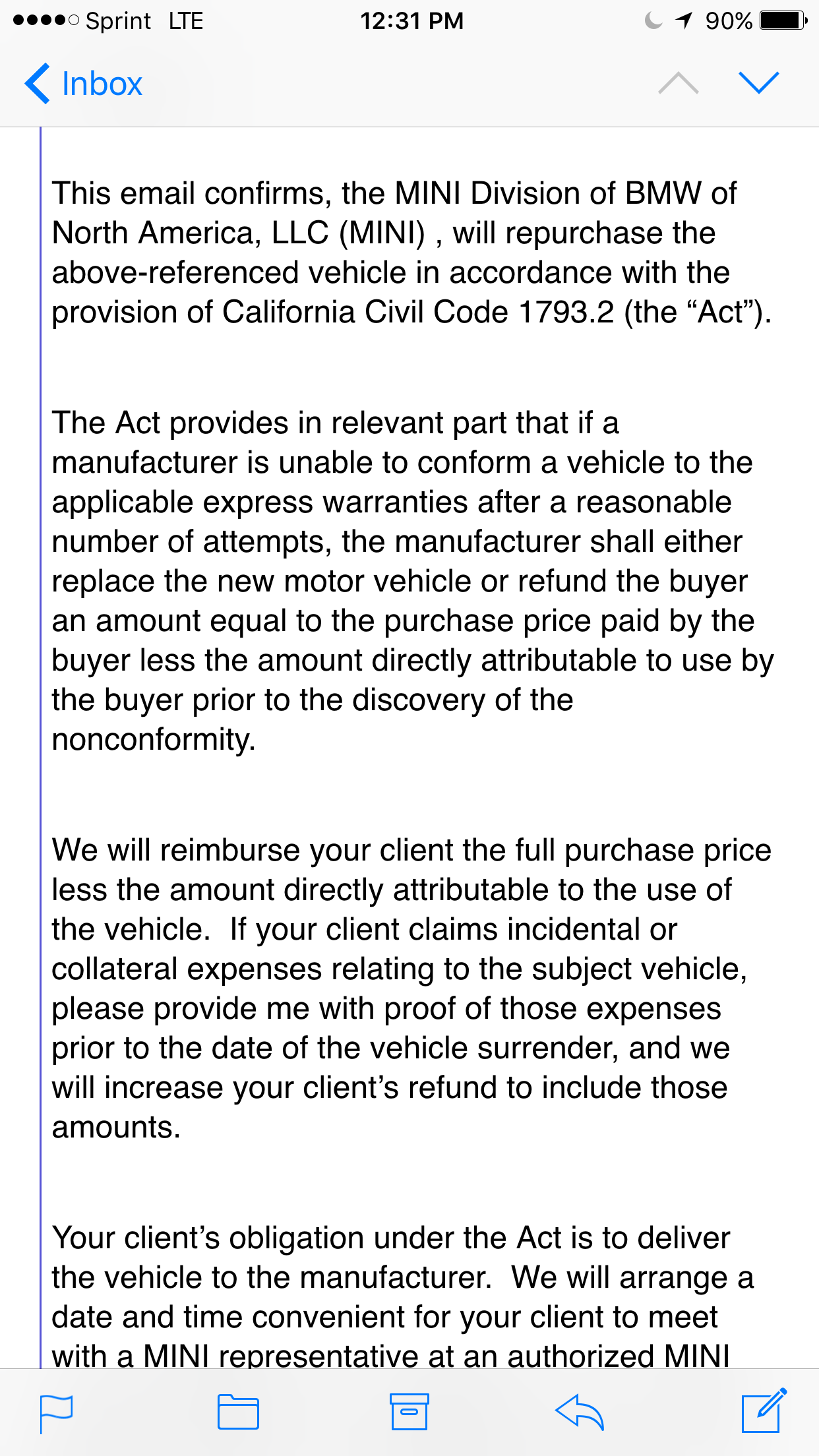

BMW repurchased ours!
We had the same problem with our '14 Cooper S. We just got word from BMW that they are going to repurchase our car. I was actually surprised at how quickly they responded, although we dealt with this problem with MINI of Monrovia for almost a whole year.

Lee No,
Please,
Can you summarize the history that led to this letter of re-purchase?

We bought the car in September of 2014, had our first problem with a musty odor in January of 2015. When we took the car in for service, was told that MINI was working on the issue and that we had to wait for parts to be shipped in from Germany. After waiting had the A/C unit replaced in April. Three months later the problem returned. Car was taken in for service again and BMW authorized a second replacement. In December the smell returned again. This time the dealership said that they could not fix the problem and that we had to wait for Mini to find a permanent solution.
We hired a lawyer, they sent off a demand letter and we just got word that they are buying the car back.

Question is "less the amount attributable to use".
They going to offer you wholesale buyback or actual full retail if the car was being sold by MINI? Going to True Car, my car is worth about $9000 less than full retail. That would be a horrible outcome if you have to take a huge loss because BMW has a poorly designed or engineered part.
Hoping your lawyer works out something better than that. As the letter alludes to, they are offering to buy back your car (which most dealers will do if you want to sell the car to them for their used car lots). It's called shopping your car to get the best price for it when, for example you are going to buy a car from a private party and want to get rid of you current car for cash. Usually best done with a dedicated Used Car dealer rather than a new car seller.
Only way to get a fair deal (IMO) is to get another identical car from them as a direct exchange.

At the end of the day, the whole ordeal only costs us $504, which is what they charged us for the use of the car for the 18 months that we owned it.
In the end, they bought the car back at the price we paid. They refunded us for the prepaid maintenance plan, paid off our loan and wrote us a check for the principal and interest we paid on the loan, refunded us all of our registration fees, and reimbursed us for our attorney's fees.
It was a fair resolution to the problem.
