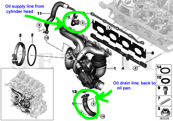

No coolant circulating through the turbocharger if you are stopping the motor all the time. I worry more about that than the starter or the engine.

You could be totally correct except for the fact that our cars are basically guinea pigs in many ways. This is what I know regarding turbochargers:
1.) The turbine side gets NUCLEAR-hot and depends on either engine oil or engine coolant (glycol) to cool the housing. If the engine is off, there is no coolant circulating through the housing, which means the turbine side (as well as bearings and lip seals) are just sitting there and cooking in their own heat. In fact, it's a common practice to install a device called a "turbo timer" in heavily modified applications, which keeps the engine idling for a number of minutes after you kill the ignition, specifically for the purpose of circulating coolant through the turbine housing, cooling the turbo down.
2.) Remember what you own and what it costs to replace what you own. Any manufacturer is going to spend and give you the minimal amount of product for the dollar since they are, well, a business. That's not to say that Mini is cheap or puts junk in their cars; I don't think they do. Borg Warner is one of the most reputable turbo mfrs. in the world.
But on the other hand, who pays the bill if the turbo needs replacing outside the warranty period? You? Or Mini? Point being, we don't know, and the question I then would ask is, "Is the possibility of replacing a turbocharger (or starter, for that matter) sooner rather than later worth whatever you feel like you are saving in gas by leaving auto-start enabled on this car?".

I assumed F56 comes with electric water pump, but I could be wrong. If yes, then there's no problem circulating the coolant during idle-stop. It won't circulate the oil though, so that may be a problem.

I don't know whether our turbos are oil or water cooled (Borg Warner manufactures both types) but even if the F56 has an electric water pump (and I don't believe it does; I assume it's driven off the accessory belt like most other vehicles...), there is nothing circulating when the engine is off.
Also, I have heard it mentioned that Mini may use a "beefed up" starter to handle the extra duty of the auto-start feature. That is all well and good except that there is no such thing as a beefed-up turbocharger. It's the same basic design they use for everything else.

george, you are wildly speculating with your semi-knowledge about modern engines!
I can also wildly speculate that the engine has a little circulation pump for the turbo-cooling (my old saab 9-3 from -03 had it. When turning of the engine a liitle electric noise was heard for a minute in certain conditions).
I can also speculate that the engine will not shutdown if it needs cooling.
There is no oil being pumped through the turbocharger after you shut the ignition off on an F56. I just pulled up the schematic from Sewell and it is indeed an oil-cooled turbine, fed from one of the galleries of the cylinder head. So, the turbo is 100% dependent on the engine running in order to be cooled.
Again, I am not saying that this will be a problem. I have no idea. This car is totally new. Nobody really knows. However, what I am saying is that it is "regular duty" turbo housing that the owner could potentially put under "severe duty" if they leave the auto-start feature engaged. What I am also saying is that remember who will be paying for it if the turbo starts using a ton of oil outside the warranty period. A turbo should live forever, but.... It's your car: Drive it how you want.

My 2007 MCS had a recall on the electric water pump that cools the turbocharger, it indeed runs when the car is turned off. It was the electical connection that was prone to causing a fire under the hood. I assume the F56 has one too.

BigNewt, the F56 turbo is oil-cooled. Fed from the cylinder head, drainback to oil pan. Only circulates when the engine is running. This is the "common" way most turbos are cooled by auto mfrs. Check out the schematic if you are curious.
All I know is that I received a recall letter from Mini stating that they would replace a pump that cools the turbocharger after the engine is shut off because in come cases the electrical connection to it would short out and cause a fire under the hood. I don't know what it pumps. If your contention is that the F56 turbo doesn't cool off if the engine is shut off then it makes no difference if it's shut off at a stoplight or in the driveway does it?
EDIT: Here's the link from the R56 forum sticky. It's definitely an auxiliary water pump that cools the turbo after engine is off. I would be surprised if the F56 doesn't have one too. One difference I notice between my 2007 Mini and this JCW is that some pump runs when I shut off the engine quite a bit more. I bet it's the turbo cooler because the JCW has a bigger turbocharger. http://www-odi.nhtsa.dot.gov/owners/...8&refurl=email

Originally Posted by TheBigNewt
All I know is that I received a recall letter from Mini stating that they would replace a pump that cools the turbocharger after the engine is shut off because in come cases the electrical connection to it would short out and cause a fire under the hood. I don't know what it pumps...
Again, that feature does not exist in the F56. It's "passive" rather than active turbo oiling. Apples and oranges.
...If your contention is that the F56 turbo doesn't cool off if the engine is shut off then it makes no difference if it's shut off at a stoplight or in the driveway does it?
Again, I don't know what, if any effect the extra duty cycle might have on turbo lifespan but on the other hand, neither does Mini. Or at least not in this case.
Just like the starter motor: It's the difference between using it say, 5X a day versus, say, 25X a day if the user elects to leave auto-start enabled. Except that the turbo is just sitting there and cooking in its own heat that many more times per day.
I'm not sure why Mini would do away with the auxiliary water pump that cools the turbo for the F56. Doesn't make sense. They auto off feature has been on Euro Minis for years and I bet they have that cooling pump.
BigNewt, just look at the schematic. There is no active cooling for the turbos on this car. Folks might not feel that it makes sense to do away with it but it's the truth. The diagram doesn't lie.
