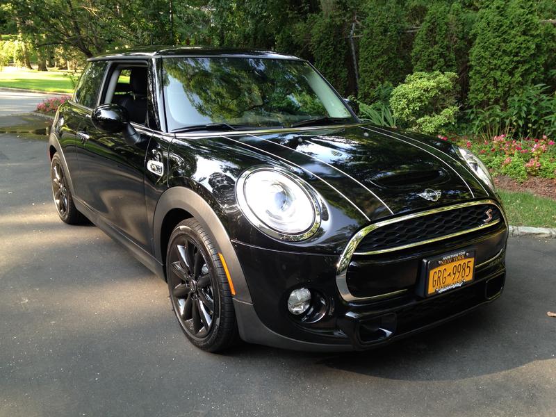

Hey guys! I'm brand new to this forum. Just purchased my F56 a week ago, MCS Midnight black. I have been absolutely loving this car. I went in last week to place my order and they almost had the exact model I wanted except for the Navi but it didn't justify me having to wait 6-8 weeks so I took it home a few hours later.
