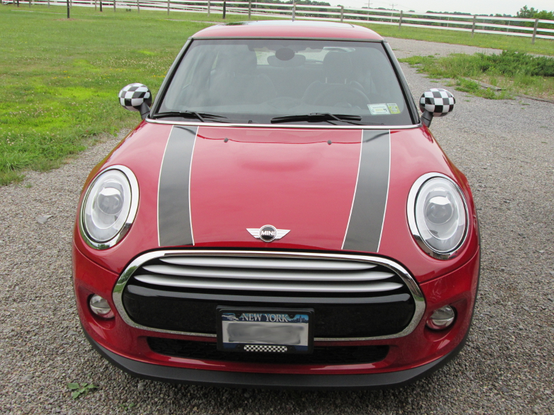

Installed my new caps today. Used the trim removal tools again, but also used a pointed scribe-like tool to help get the tabs to release...finished both mirrors in about 10 minutes with no broken tabs (and therefore no cursing!).
Here are some pics - at least, I hope they upload OK. I've tried several times to upload them into my 'garage', and keep getting database errors (??).
BTW - the new caps protrude a tiny amount (1/16"?) beyond the mirror border, all the way around (both mirrors). Not really noticeable, but the stock caps I removed were completely flush. Wondering if anyone else ran into this.

Looking good! I'm hoping to receive my checkered caps sometime this week.
