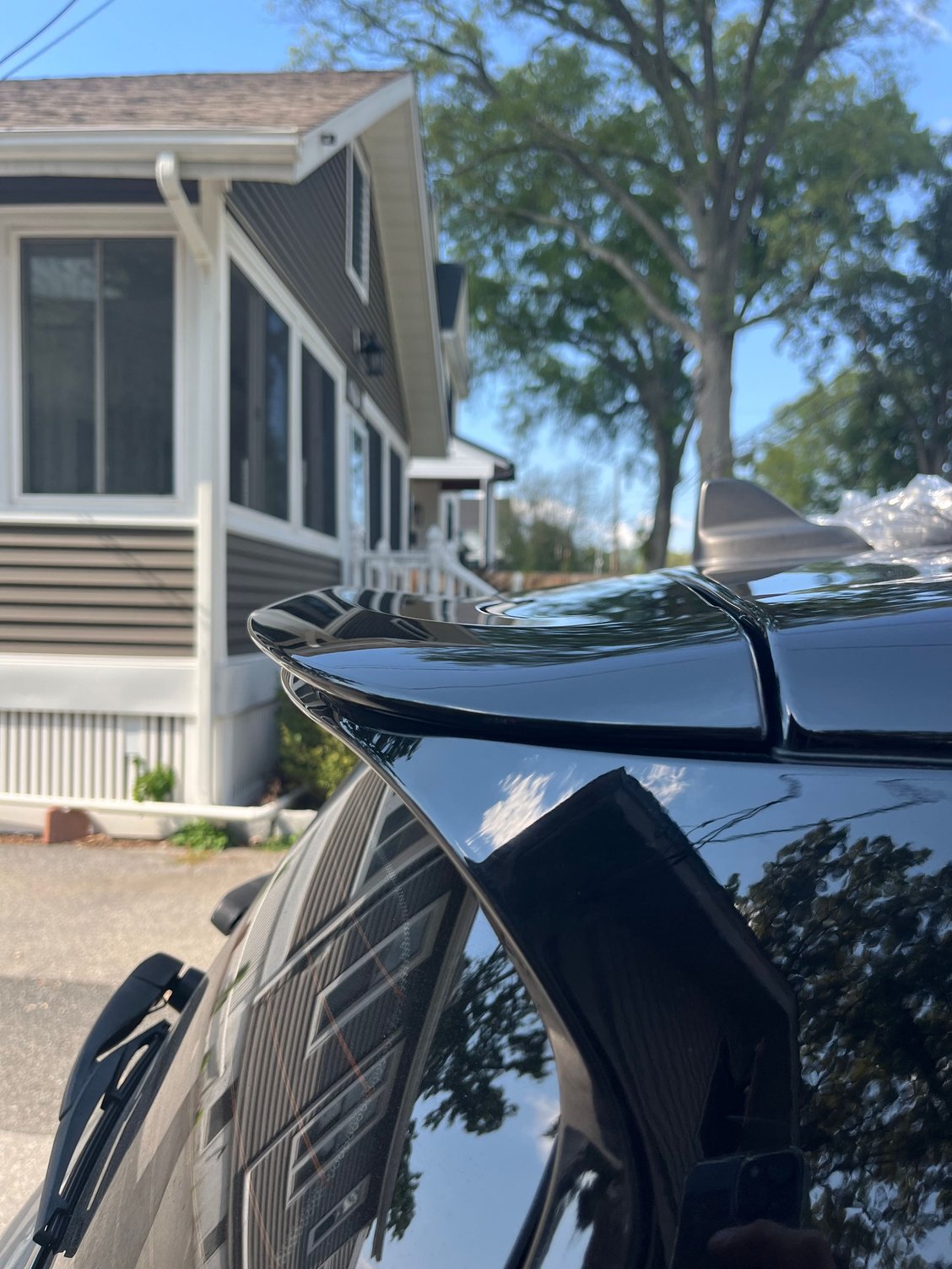

I need to remove the rear roof spoiler on my F54, I searched online and there isn't any tutorials. There are plenty of F56 rear roof spoiler removal but none so far for F54. Anyone has any experience with this?

2 Clips holding headliner 4 T25 Screws to release rear wing Use plastic pry near antenna to release clip Then work your way our to release the corners. Each corner has 2 spring tabs...go slow and be gentle. Easy swap to JCW spoiler

F54 S Spoiler
F54 JCW Spoiler
