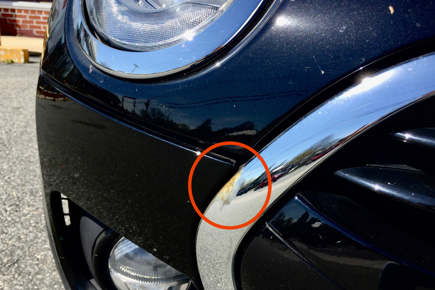

Good day to all. This will be my second summer with my F54. I love my cooper, looks and performance. Has anyone ever seen staining by the front wheel molding and front grill? It's a glue like substance. I've taken it to my mini dealer and nothing had been done. Only an explanation. It's from the packaging material in the hood from when it's shipped. I was told it'll melt away after a hot summer. I'm meticulous when it come to my cars. Spent $30 on a deluxe car wash. Car appeared to be clean, until you see the wheel moldings and front grill. I plan on contacting my mini advisor again but has anyone experienced anything like this? And if so, was it resolved? Frustrated to say the least, please help.

It's cosmoline residue, they spray it on the car to protect it during shipping. It often gets into nooks and crannies and they don't get it all when it is cleaned for sales.

Wow, that's a bad case of it. They should clean or replace wheel arch trim under warranty. On my car it stained aftermarket clear shield, never got it off and wasn't dealership issue.

I had the same ooze near the right front headlight onto the chrome also. A little mineral spirits on a soft rag solved the issue for me. So far.

According to Wikipedia....Cosmoline is the genericized trademark for a generic class of rust inhibitors, typically conforming to United States Military Standard MIL-C-11796C Class 3, that are a brown colored wax-like mass; have a slight fluorescence; and have a petroleum-like odor and taste (as detected when working with it).
It is a well known rust inhibitor used on surplus firearms. Usually, recommended cleaners range from mineral spirits to diesel to kerosene. I would say mineral spirits would be the best bet.....

Certainly looks like dirt mixed with Cosmoline or whatever specific rust inhibitor MINI uses. I know the undercarriage on my former Subie was just slathered with it, which is kind of funny as it was shipped all the way from SIA in Lafayette, Indiana and not Japan.
I agree that mineral spirits would be your best bet, but you could also try some Turtle Wax Tar & Bug remover as well. I have never had any material compatibility issues with that in the past (i.e.- the plastic wheel arch). Good luck.

Your dealer is simply lazy. Definitely a warranty item.

Here's an idea I'd try. A hot soapy solution should soften it adequately. Soak the effected seams really good and pull the soapy goo out with a wet/dry shop-vac with the hose cuff against it. Repeat as necessary. Eventually you'll get it all pulled out. Consider it as "flushing" or "purging" it out. Years ago I had to go pick up a bunch of new M-60 machine guns for an aviation unit we were activating from scratch. Each 60 was packaged in plastic with Cosmoline gooped in every crevice, so I know how messy the stuff is. Try this positive thought (or mantra): it could be worse. There's much worse CPC's (Corrosion Preventative Compounds) out there that sets up hard. Just find out the maximum temp of water you can use and stay under that...and flush away!
