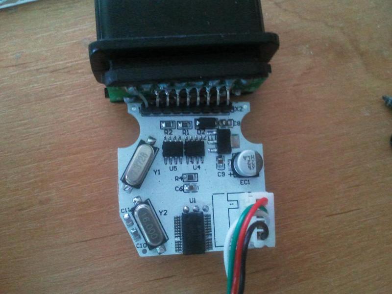

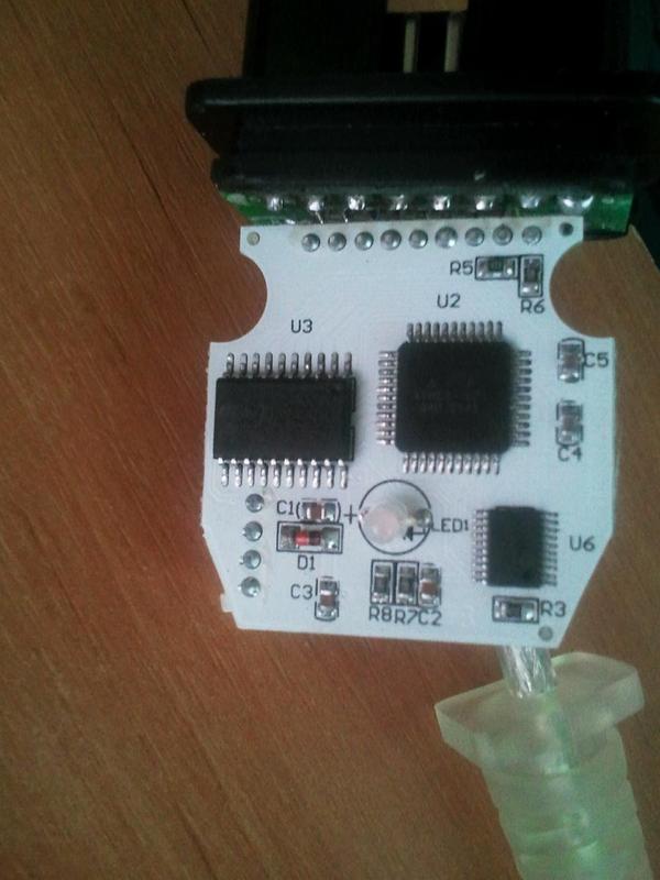

Hi All,
I have this Ebay interface INPA k DCAN. Is exactly the same, FTDI 232
I want to Scan my Mini R56 S 2007 but always have this pop window.
Variant checking
IFH-0009 D_MOTOR
Program will be stopped
I read that INPA and NCS Expert have to work with pin 8 and 7 pin for DCAN (jumped) or pin 8 physically disconnected.
So... My question is that if my INPA interface is correct wired???
Or maybe my Inpa software is not complet????
Im working with Inpa 5.02 Ediabas 6.4
Hope any can help me.

I update datens, I update Ediabas to 7.2
Now I can read many modules, only I cant read Engine and Gear BOX hmmm
