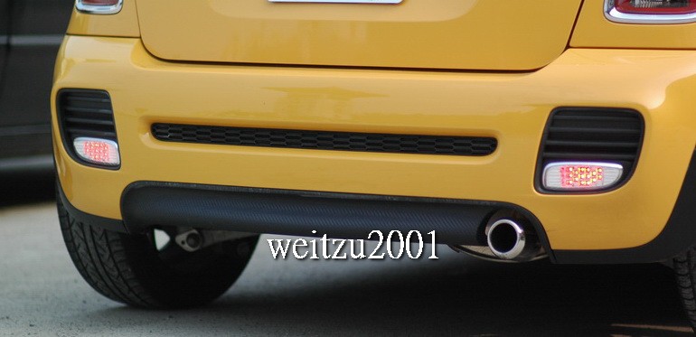

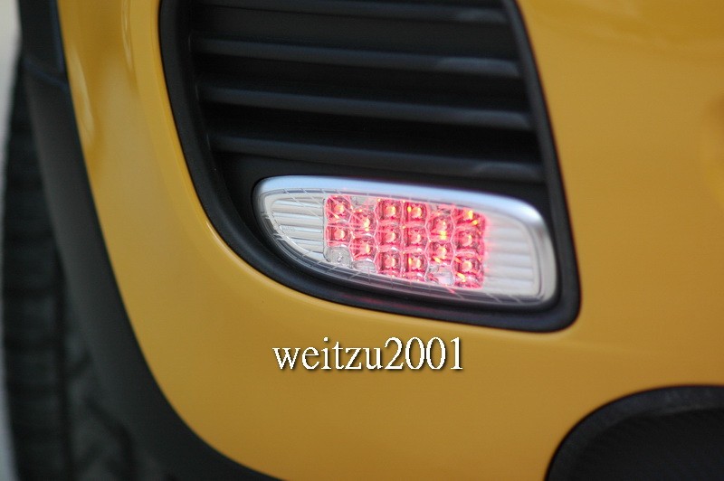

Just wondering what options we have for the Rear Fogs. I know a lot of you have the Rear Fogs so was hoping to make a full list.
My R56 did not come with them but I am adding a JCW rear and the rear grills have a space for these lights so I was exploring the options. I may just add them as additional brake lights. Does anyone know if they would be way too bright?
Please add if there are any other options not listed below.
Standard OEM Pre-Face
- 63242751707 Fog Left
- 63242751708 Fog Right
Standard OEM LCI (JCW Aero Only) - One Side Reverse w/ Rear Fog Option, NO FOG OPTION = 2 Reverse
- 63247241801 Backup Left
- 63247241802 Backup Right
- 63242751707 Fog Left (same part number as pre-face)

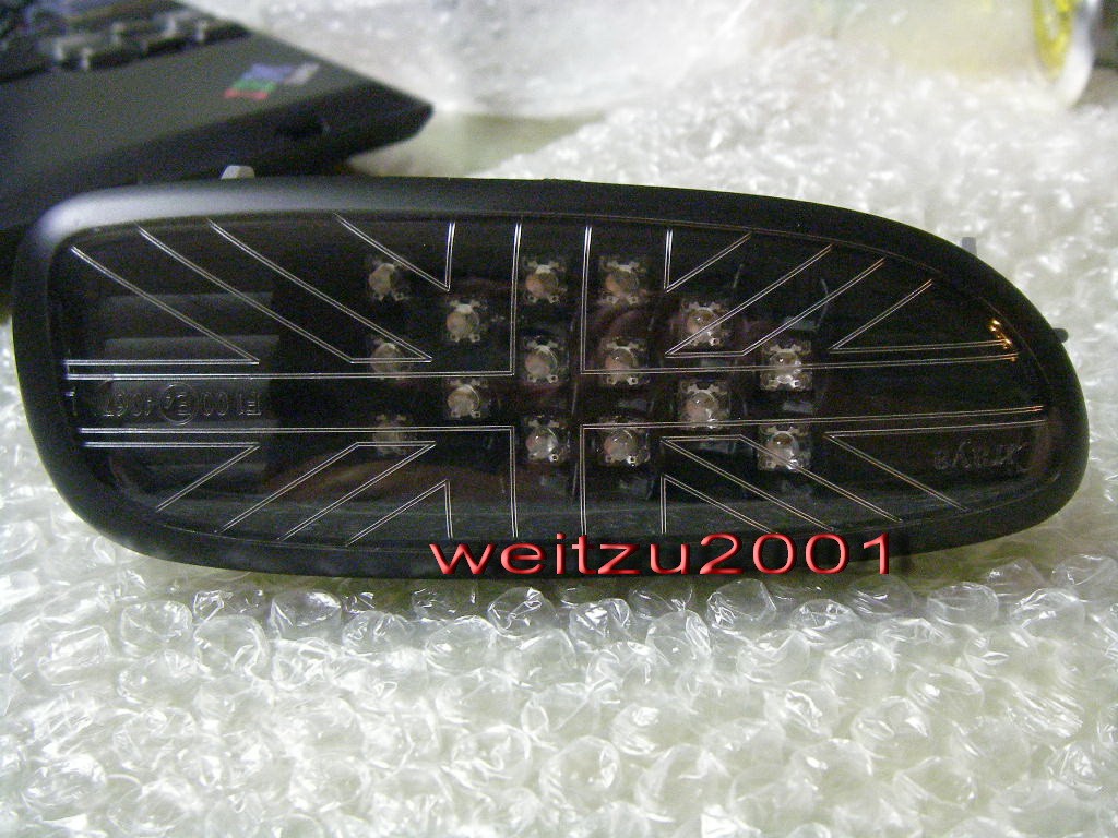

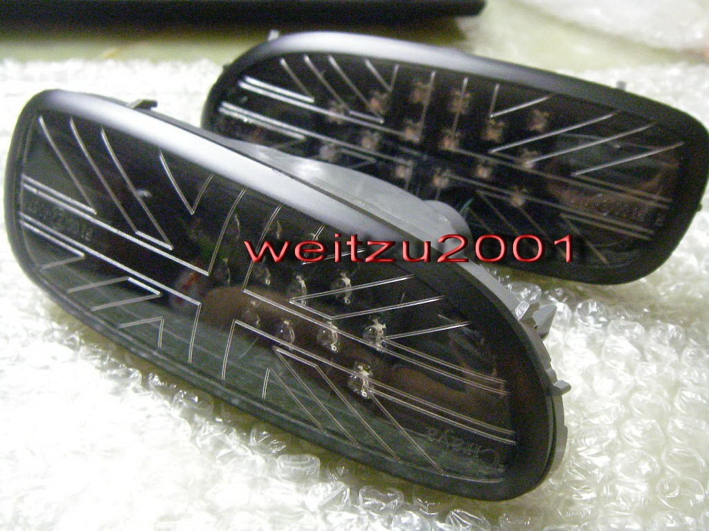

Black/LED Union Jack by Dectane

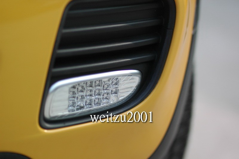

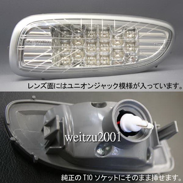

Clear/Chrome/White LED Union Jack by Dectane
Black/Clear Comparison
Standard OEM Fog Delete - Black Plastic Grill Pattern

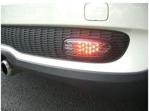

I ended up just ordering a set of 2010+ LCI rear backup "fog" lights. Should be a pretty simple wire-up to work with the reverse lights. I don't know if its just me but they look more modern than the all red fogs. I figure I would have more use of reverse lights since the stock reverse light setup isn't exactly bright.

I justcwent with the standard red lights, cleaner look for me. The plugs/harness was already there (taped above the foam bumper piece). Just plugged them in and tapped the brake feed located behind the trim on the passengers side. They function as running lights and brake lights.
