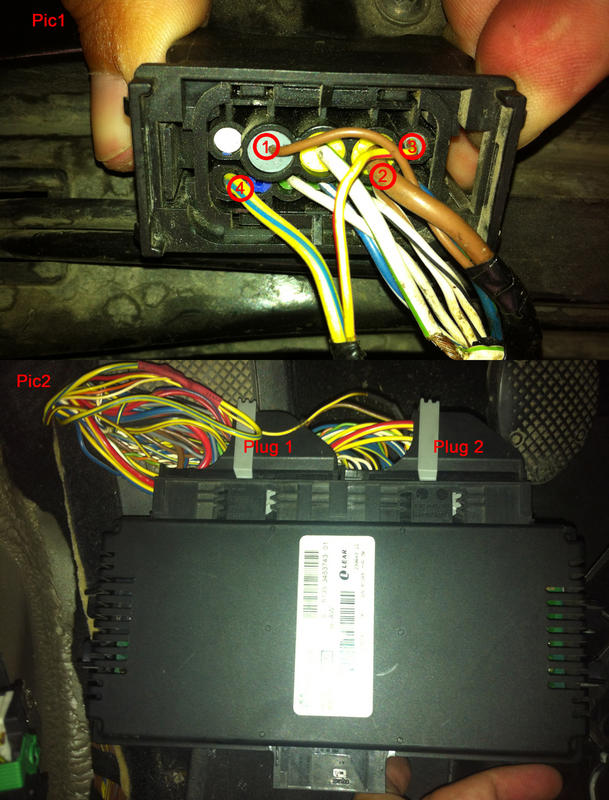

As you see in the pic1 you have to join 1-2,3-4 of the headlight connector .
3-4 are for the high beam.
You have to unplug the two yellow-blue cables of the FRM plugs, join them together(Pic3-Pic4) and plug it as one now(BMW give it as Yellow-Red) to position 41(Pic5) of the Plug 2(Pic2).
Also you have to add $522 to CAS and FRM and reset FRM.
If you don't code, xenon won't work.
If you don't join cables highbeam won't work.
After that you will have errors in FRM because of missing autoleveling sensors.
There is a way to deactivate these sensors and do these manual,as with halogen,but i'm still looking for that.Also there is a way to avoid joining cables and make the highbeams work only with coding.I'm also looking for that.
Attached Thumbnails Help-replaced halogens w/OEM Xenons and they dont work-img_05562.jpg   Help-replaced halogens w/OEM Xenons and they dont work-img_05582.jpg   Help-replaced halogens w/OEM Xenons and they dont work-img_05592.jpg
Hey Bearheros,
So I got the xenons on my countryman, got the low beams to work, (though it throws errors), but when I undid my FRM and took a look, the connector looks the same but my wiring and wire colors are different..
Here's a pic of my 2nd connector on the FRM, do you think the wiring is the same? I think the FRM is the same between countryman and r56.
Old Nov 7, 2012 | 05:01 PM
  #39
bearheroes's Avatar
bearheroes
Joined: Jun 2011
Posts: 68
From: Hellas
yes i think it is the same...but for doing anything check the cables from headlight plug,to which pin of the FRM plug do they go.Just to be sure.

Posts: 68
From: Hellas
it is 4 wires if i remember well.2 from each sensor to JBE.
Old Jun 1, 2013 | 11:21 AM
  #49
Shoe Coupe's Avatar
Shoe Coupe
Joined: Mar 2012
Posts: 376
the fires goto JBE or to FRM?
