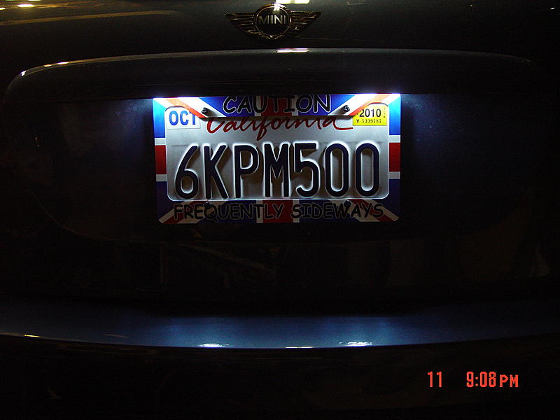

The canbus led's didn't make it in yet but I had ordered a few sets of non canbus LEDs for the heck of it last week, thinking they would work on my Armada (which takes 3 sets on the interior) if they didn't work on the Mini. Well if I only use one LED and one stock bulb, they do work on the Mini with no bulbout. I put the other one in and bingo, bulbout. To top it off they are too big for the Nissan.
Update: they work in the 05 MCS Plate because that car doesn't monitor bulbout
, they work in the 05 trunk, (there is an error in the osram bulb chart for 09 JCW for the trunk so watch out) they work in the 05 MCS and 09 JCW glove box.

OK guys,
I am pleased to report the canbus LED's work! No bulbout warning. They fit snug just like OEM. No tab bending, tweaking or soldering necessary. I was very skeptical when I opened the box because they appear to have the identical set up as the standard LED's in the above post. There is no visible load resistor as I have seen in other systems. The pills are larger and possibly draw more current, just enough to be within the threshold of our systems. Remember the others are very close to making it too. These are just slightly brighter than standard.

No bulbout, no problems. I have been using them for a over a month now. They run cool because they dont use on board load resistors. They have sized the LED's just right to avoid the bulbout and we get the powersavings benefit too. I would buy again in a heartbeat! And in case you were waiting for me you are in luck because they are on sale for 13.98 right now! remember to get the car specific, bmw e46 plate led's not the other ones in the general section.

Do you think you could post a picture of the license plate mounted LEDs? Thank you for the link, I will hopefully order some soon. For some reason 1 of the license plate bulbs went out along with both of the overhead interior lamps at the same time
Really? Wow, usually incandescent bulbs last forever. if you need any incandescents just for checking your fuses, I have a ton of extras (send me a PM and I'll mail you a good bulb). At least you have a great excuse to upgrade
In my gallery is a pic of some other plate lights that gave me a bulbout on the 09. The same led's work great on the 05. I since have the error free type installed and they are just slightly brighter and coloring is the same. Do you want a non powered picture showing the bulb installed? Let me know and I will update this post with the pic you need to see.

Hi smoke05S,
I finally installed the LED light bulb (from http://www.ledautomotive.com/product...d_product=129), it look great!
Notice, the LED will blink/flickering whenever the interior light (at the roof) is on, but this will not happen if the headlamp is on at the same time.
Above is ok with me but what get me worried is when the car engine, light, everything is off, the LED light still on - in dimmed mode - for very long time
is this normal? Will it drain the car battery?
is this normal? Will it drain the car battery?Thanks
