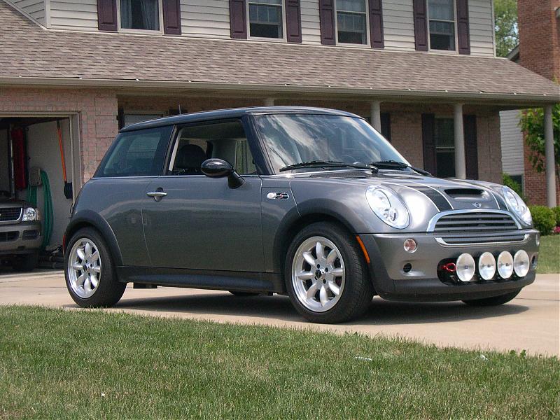

Hey all. I finally got a couple of pics of my light bar installed. The lights are Hella 500's, 2 fog and 2 driving. THey work in conjunction with the regular lights, when the lows are on the fogs are on, when I toggle the high beams the fogs go off automatically and the driving lights come on. I put a switch on each set of lights so I can turn them off if needed. I am attaching the schematic, if there are questions, drop me a line. I will post more pics in my gallery soon.
Dave

I did the whole install for less than $150.00. THe lights were 54.00 and 52.00 on Amazon, the Stainless bar and angle fabricating were a case of beer at work, and the extra relay and switches were about 20.00. Not too hard for a DIY install.
Dave
