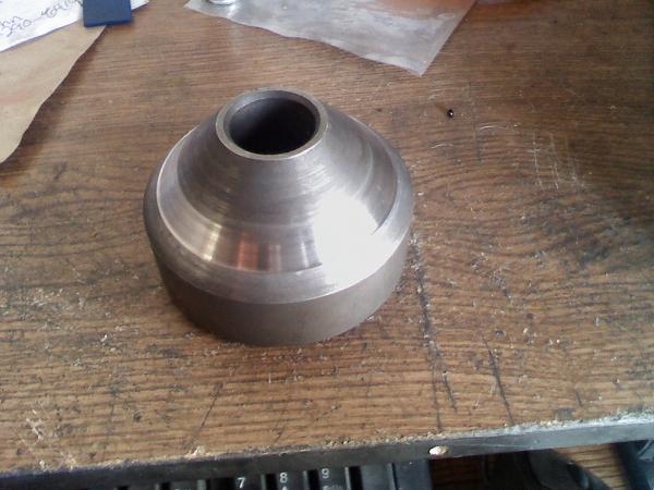

Ok, i managed to have a piece of tooling made which will allow me to expand a piece of pipe to the correct OEM angle and diameter.
The cats I use are highflow metallic cats yet they will not trigger a cel when installed. I just have to see how i get them to fit in place.

What exactly is this part for........NO I dont mean the downpipe, but the flange or spreader?

Im guessing to maybe bend the connection end in a way that is restricted by the diameter of the piping? other than that just my guess, Im no genius like hector =[

You have to form a staight piece of pipe to a flare thats 40degrees just like the oem sestup. The common setup is 45 degrees here in the states so if i was to flare the DP to a 45, it will not seal to good on teh donut gasket.
