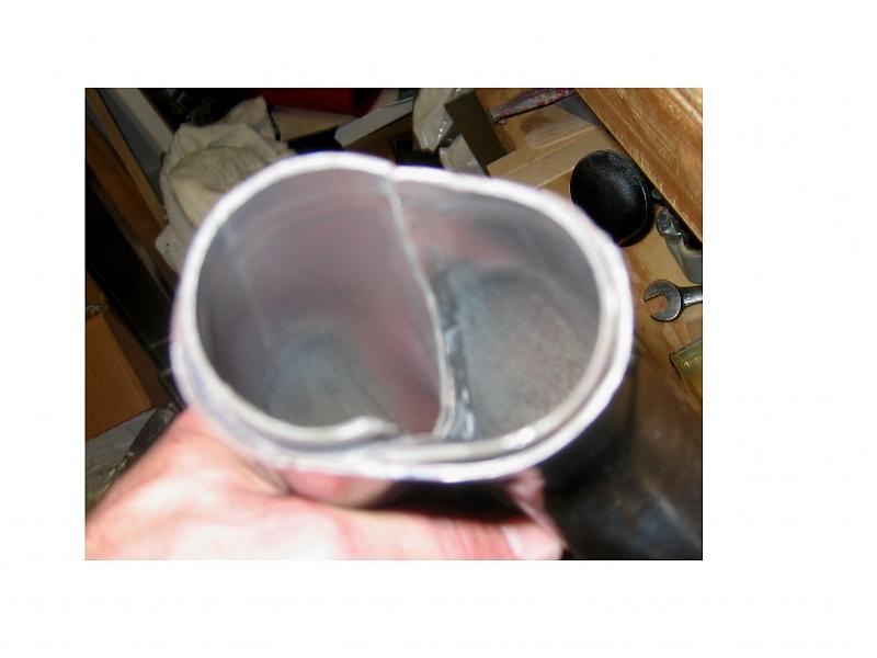

Looks OK. Hard to get a good picture of it, this is the best I could do.

Thanks not bad at all, looks good.
Sorry to hear your having this trouble with your OBX and like I said this looks very fixable.

I appreciate the vote of confidence on being able to fix this. BTW, a magnet has no attraction to the metal in the joint area (or anywhere else on the header). I do have one of the Lord-of-the-Flies dampers, but I don't think it does a whole lot of good. Clearly the source of the problem was the over-tightened ball joint, but at the same time the joint on the lower connector was not welded too well. Probably the weak link in the header construction.
Old Nov 20, 2006 | 05:03 AM
stevecars60's Avatar
stevecars60
Joined: Mar 2006
Posts: 1,710
From: Northampton MA
Thats not all.......
The colector looks as if the weld penetration was poor, if at all. The pipes below the collector acted like a heat sink. If this had been a true butt weld it might not have failed.
FYI, you could have the pipe re-welded with ( mig ) mild steel wire. It should work fine. It will rust somewhat but unless you plan on it being an art piece on the livingroom wall, who cares?
