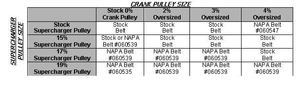

I put the Alta 15% pulley on my 04 MCS. The only other mod was a milltech exhaust. While it was being worked on I also had the mechanic replace the belt with a Napa 060539. As others have said up til 3500 rpm seems normal...after that it definately gives me a really nice kick.
By the way...the old belt looked perfect but for $20 I replaced it anyway (only 19,000 mi on it) Now keep it in the boot as a spare
Attached is a belt matrix that another poster pit up a while back
Attached Thumbnails Not much different after pulley?-alta-belt-size-matrix.jpg
