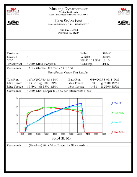

got it. That is a test that would be nice to see. Basically Randy's test (when ever he gets it done) will have the HAI along with the AGS, Rouge, Alta. Should be pretty good to see. Normaly the intake temps don't make a huge difference, on other cars. But with the mini, since the IC is already somewhat hindered by air flow and other things, i think the cooler the air the better. Now it may only be worth a couple of HP, but with our air box and the hose that couple of HP can add up to enough to make it stand out.
Matt,
Your thereory of the TB being the same size sounds good, but it doens't work. Say you have your TB and a hose attached to it that is the same size as the TB. If it is 1FT long it will be X restirctive. If you make it 4 ft long it will more restrictive and loose power. Like if you take a garden hose and try to blow through it (10ft long) then cut it down to 3" long it will be much easier to blow through.
Attached are a couple of graphs of a 19% car with and with out the hose showing the difference.
Attached Thumbnails MINI-Madness cowl mod with ALTA intake?-altanohose19chip.gif   MINI-Madness cowl mod with ALTA intake?-altawhose19chip.gif
