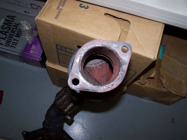

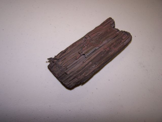

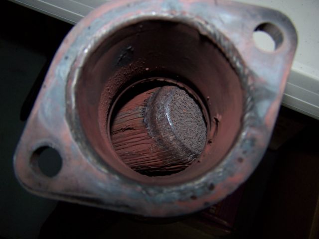

Here is my burned out Madness Header -Version 1, I have the Miltek CAT back
Note the CAT extruded into the pipe, pulled an O2 sensor with it .... power way down, lost 20 mph down the straights ...It also git more quiet
Hopefully, George is sending me a new one, version 2

wow! that header looks awful! have you heard of any other madness headers self-destructing like yours did? my car seems to run the same way as it did when I installed the header back in 7-04. I don't track my car, and it only has 8,500 miles since new. let me know if other madness headers are coming apart. did you notice a small breathing gain when you first put it on- and how long before the performance decreased. thanks-
Old Sep 17, 2006 | 07:24 PM
RED FURY's Avatar
RED FURY
Joined: Oct 2005
Posts: 785
From: oHIo
Yes,
I noticed a small gain, especially up high in rpm....
I put 7000 miles on it, a lot of track time ...
version 2 header is supposed to be better, we will see
