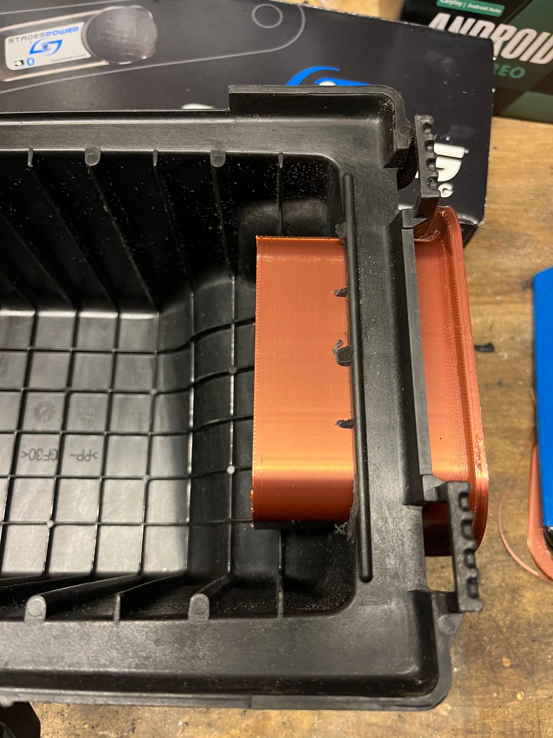

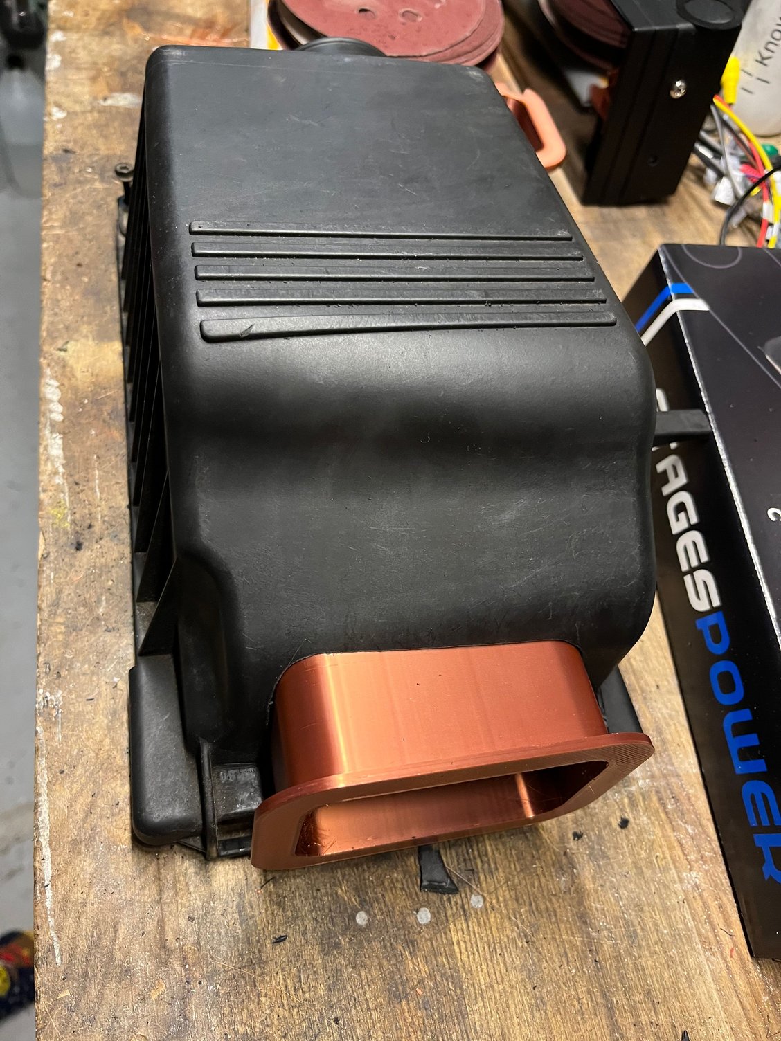

Since it gets harder and harder to find a JCW airboxfor reasonable money, I decided to have a go at a homemade version built on a standard airbox.
So pulled out the CAD drawing tool of preference (Shapr3d) - and drew up two parts. An adapter for the original JCW airfilter, and a “funnel” like to original JCW.
The lid of the original airbox got attacked by a dremel - and the new “funnel” could be pressed into place. The filteradapter is 30 degree and is just pressed into the original inlet on the lid.
​​​​​​…Next step - get a new airfilter and draw up a lock for it, just like on the original JCW, and testfil it all.

The 3d printet parts are still prototypes, so printed in the PLA that was in the printer - will be printed in either black ASA or PETG when printing the final versions.

Oh that's SWEET!!!
Nice work and so much better cold air draw with that big mouth intake.
