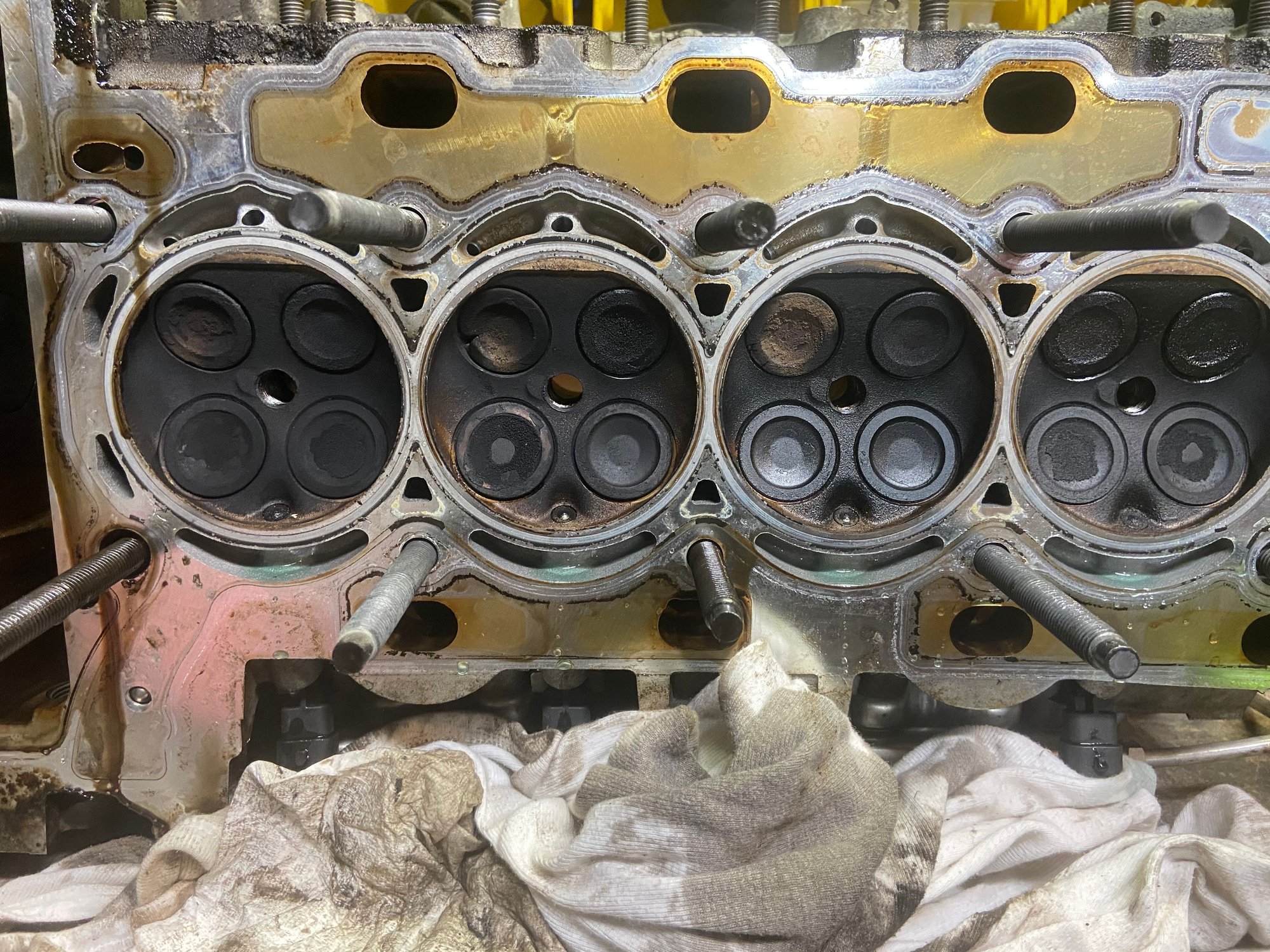

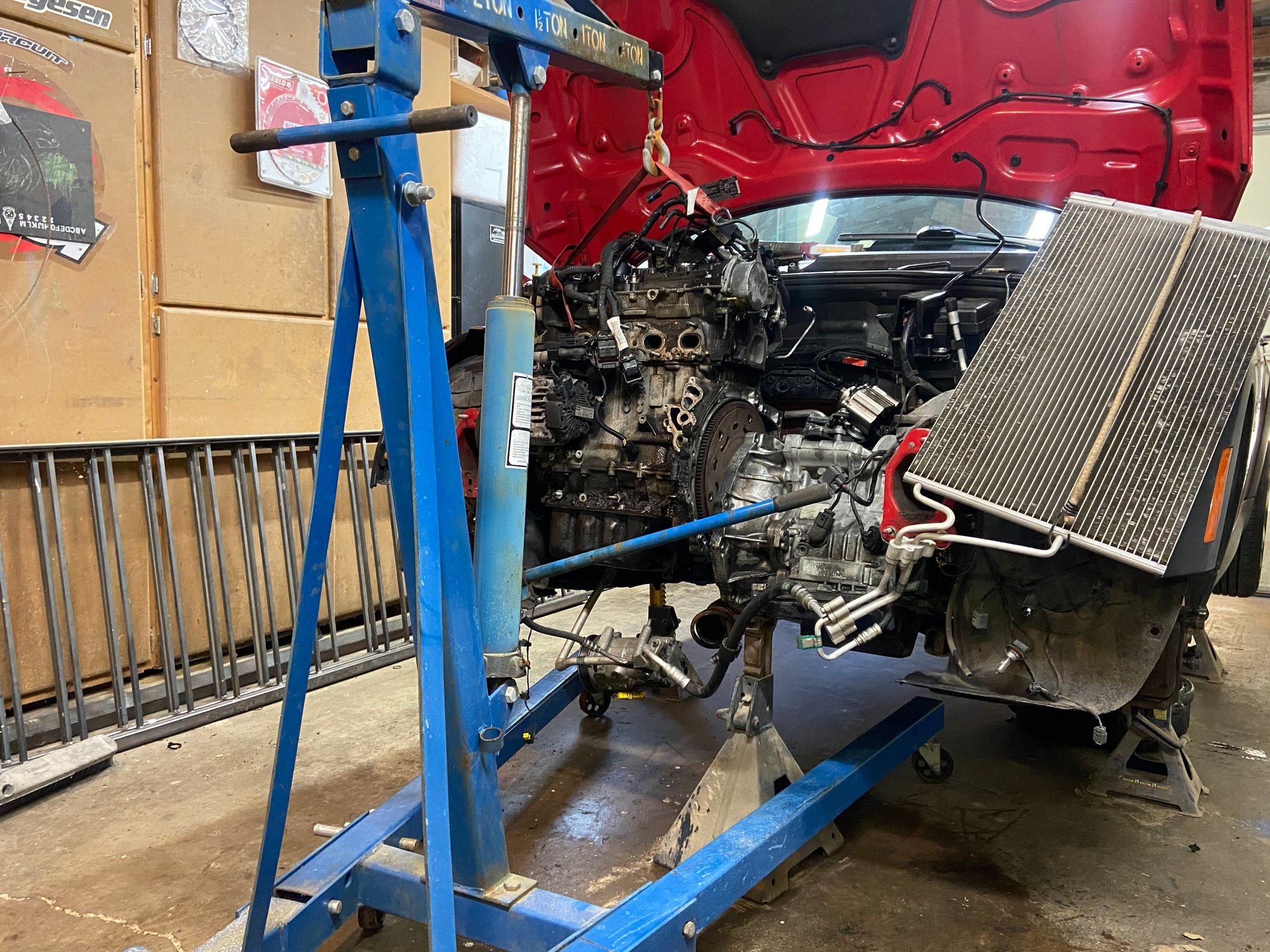

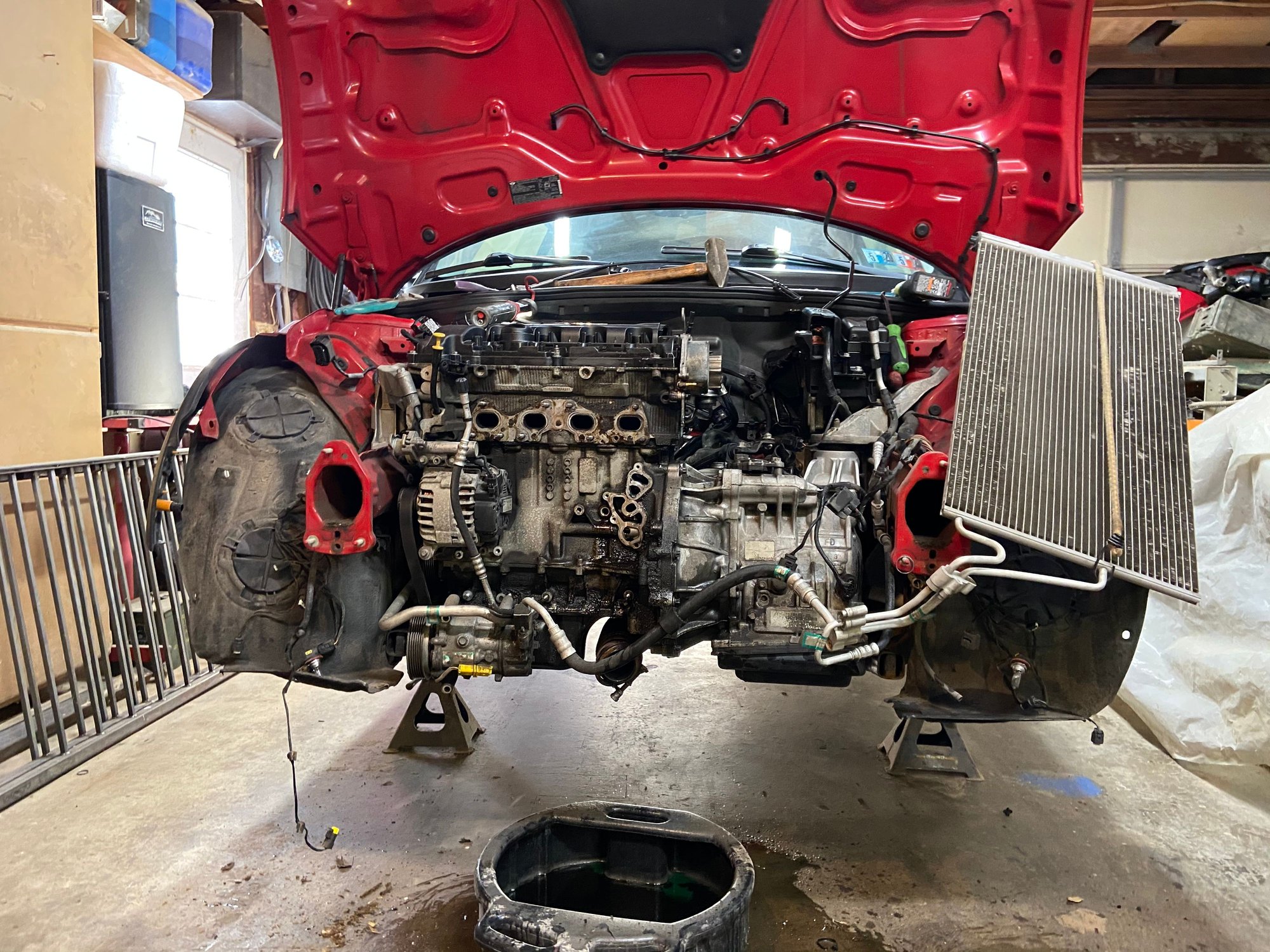

Update #1

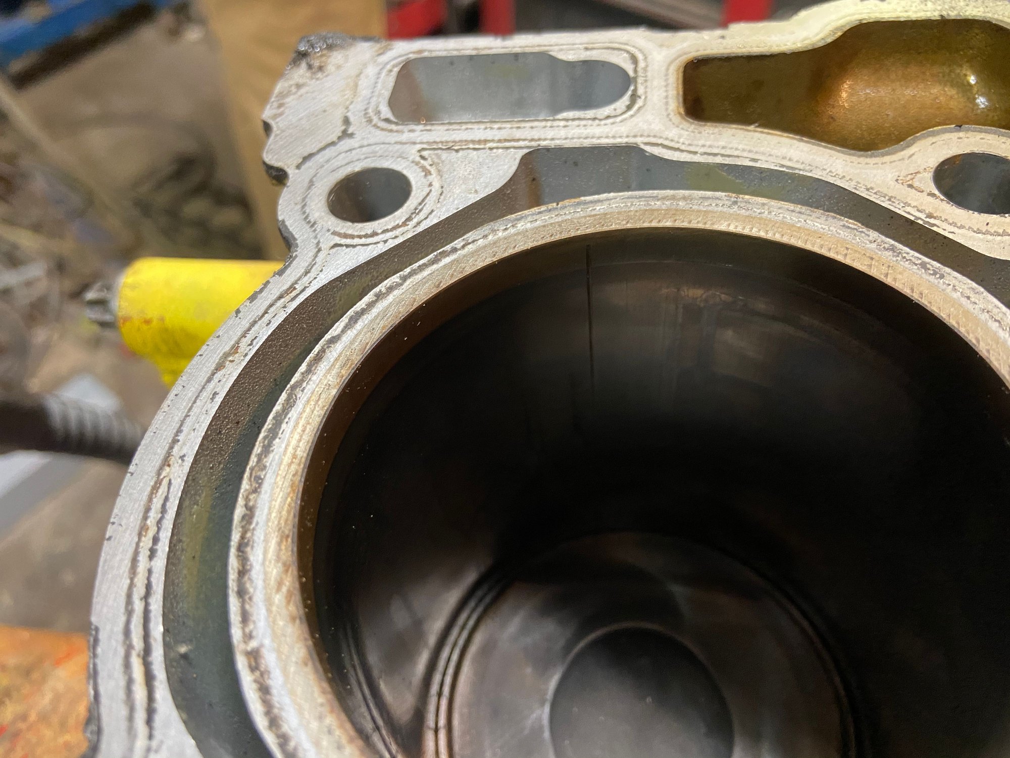

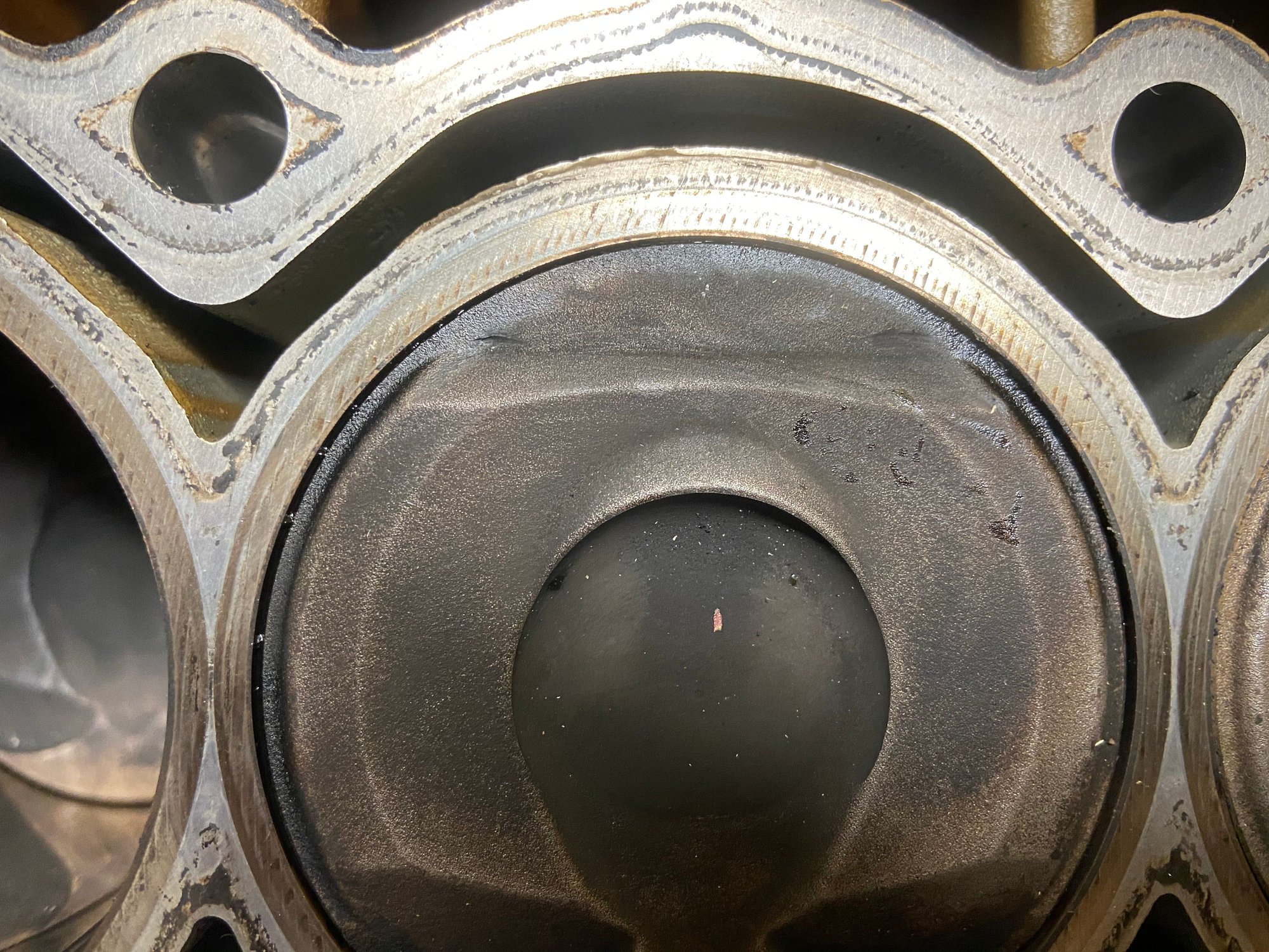

Hey figured I’d update this post since I got the Motor pulled this weekend. Turns out someone put an LKQ motor in this vehicle at some point. It looks like atleast 3 pistons hit exhaust valves. One valve definitely bent. One bent and broken (didn’t pull the head apart yet). 3 cylinders badly scored. I don’t know if 77.5 bore is going to get it out. But here’s some pictures of the carnage. So if anyone knows of a decent block laying around let me know.
ah that’ll buff out

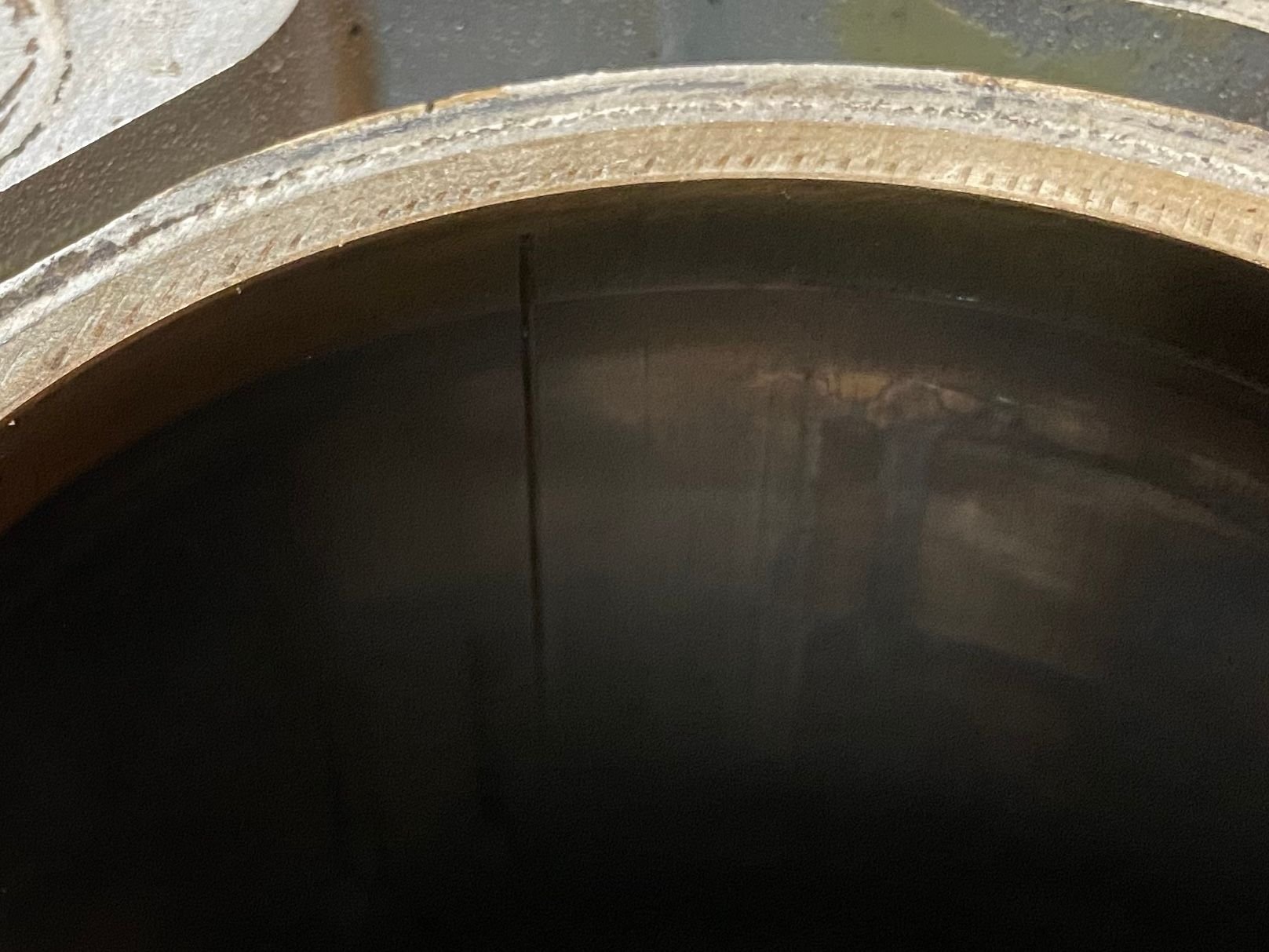

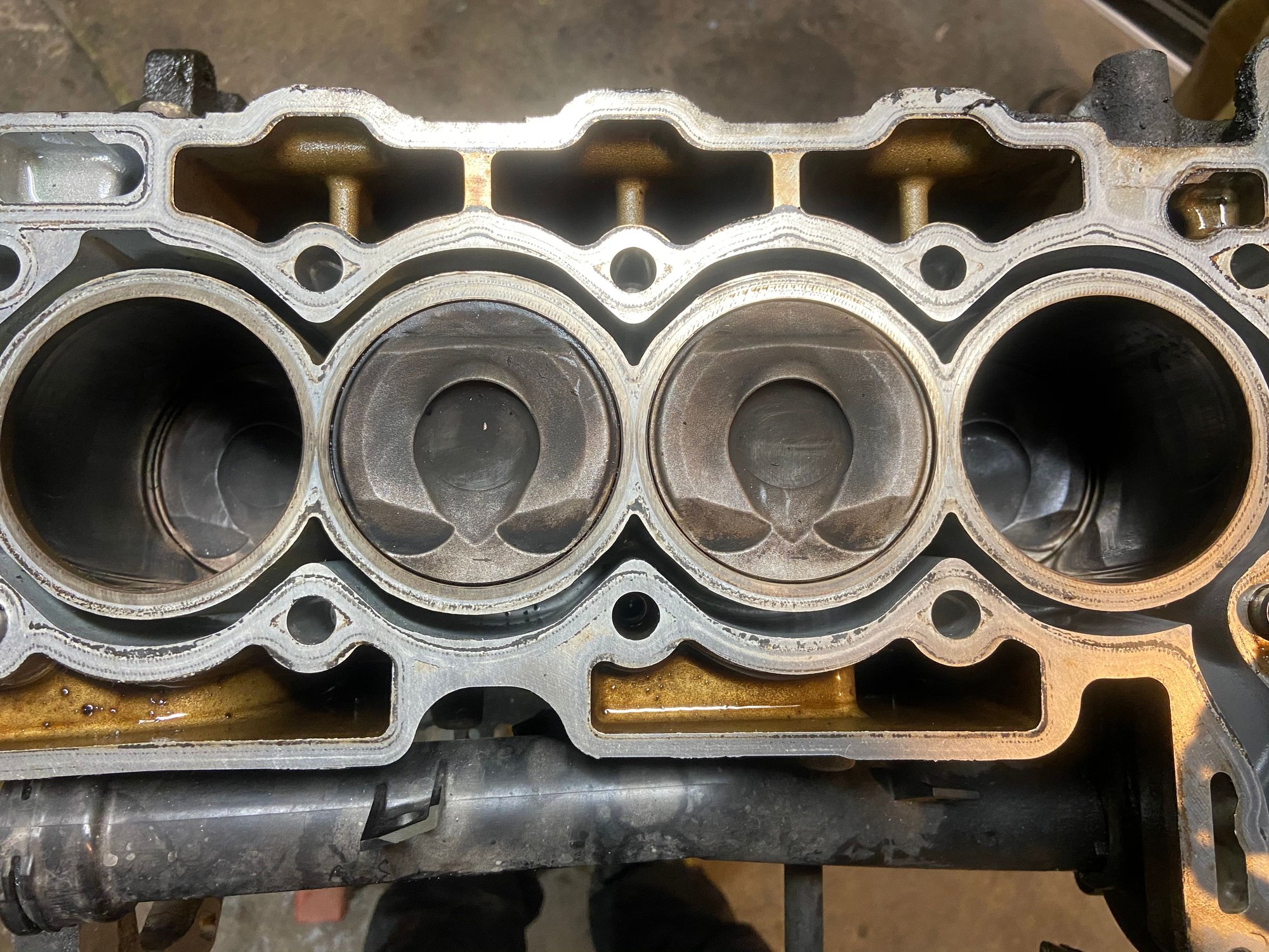

Cylinder wall.
Another picture of the cylinder wall.

The valve dome and the piston top are all looking good, only a slight film of carbon build-up. I remember when I pull my head out and first look scared me off, it was all gunked up with the valves and piston top has build-up which took me two-weeks hand-scrubbing them off (hobby time spent, not 8-hour work-day style).
After you clean it up and put it back together, it'll feel like a new motor. It's how mine felt, took all the shudders and shakes out of the equation just by cleaning up. Happy motoring.

Did you see the cylinder walls ?
Old Mar 15, 2020 | 09:49 PM
Yupetc's Avatar
Yupetc
Joined: Jan 2018
Posts: 483
Likes: 146
Not really that much worried about cylinder walls. If you take a honing tool and hone the walls slightly to smoothen it out, you will be fine without having to worry about sleeving or changing to the next larger size piston. At least my cylinder wall didn't look like yours when I did it, and I didn't even hone it and it came out just fine, strong compression and all.
EDIT*: Nevermind what I said, just caught a glimpse of your close-up pic on that scratch. That scratch looks deep, and you will have some serious work to do if you are going to re-use the short block. In this case you will need to get some shop to cut your wall out and size up the piston to match. Else, you're looking at an engine swap. I don't think if you buff that scratch with some honing tool can actually get you squared away, you'll likely have some compression leak with it.

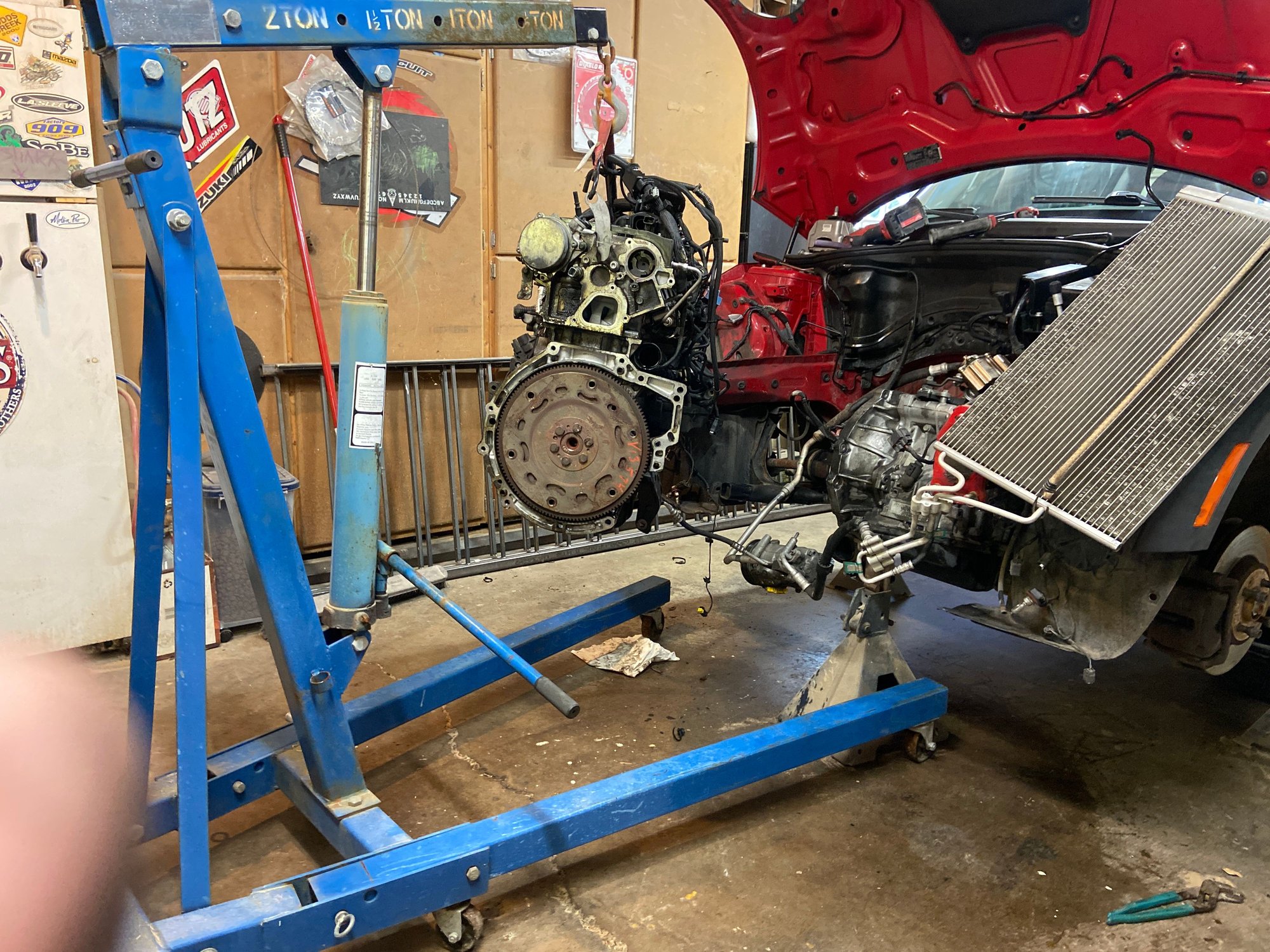

Hey guys been awhile sense I posted. Wanted to update this. Soo I went a picked up another motor. The story is the vacuum pump went bad broke the exhaust cam bolt for the timing sprocket etc. I have heard of this failure before seems common. Looked the motor over 2 bent valves in one of the cylinders. Obviously hit a piston. Didn’t see any other witness marks where valves met piston. Regardless all I really needed was the block and crank. I’ll take some better pictures tomorrow when I get it up on the engine stand disassemble it completely etc. was told the motor had 89k on it.
On a side note I am really curious about the Darton sleeves. The pricing I have found is around 1200$ just for the sleeves and I’d have to find a machine shop that can do it. I’m sure the labor will be considerably expensive as well. But I mean I guess with a block like mine where the cylinder wall is scored beyond a .5mm bore that’s really my only option or scrap the block?
