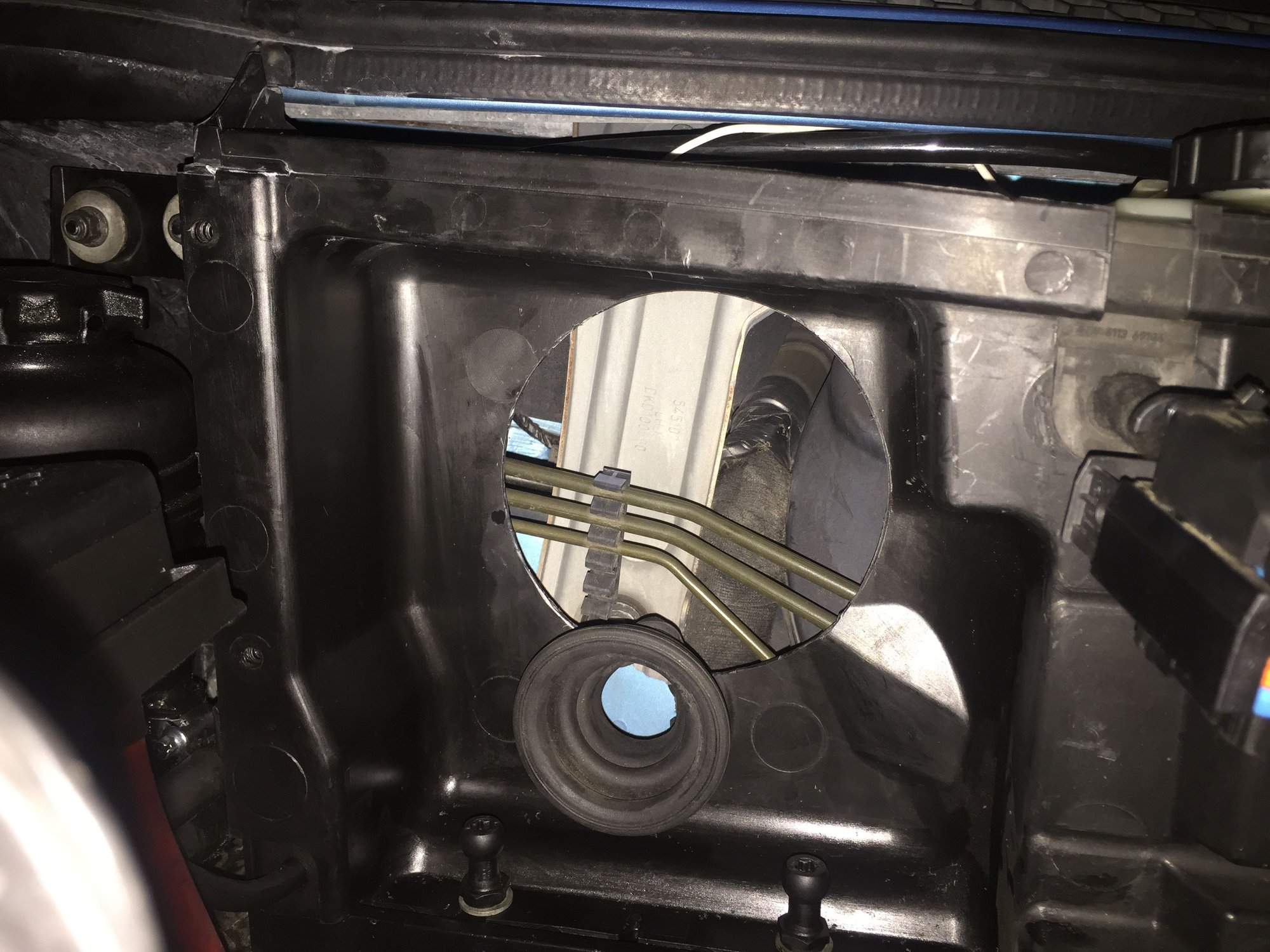

I am posting this because when I was researching the subject I found the information insufficient, especially on the cowl mod. I am hoping this review and pictures helps someone else out.
My car is 100% stock engine/exhaust wise. This is the first mod I am performing.

Cowl Mod:
Harbor freight sells this kit:
http://www.harborfreight.com/34-in-5...-pc-69073.html
It included a 5" hole saw for $16 total, much cheaper than buying an individual hole saw.
I drilled a 5" hole in the cowl. The hole overlapped with the small factory cold air intake hole about 1/4 of the small holes circumference. I was still able to use the factory grommet. I did this because it rides against the lower part of the factory air box, possibly stopping vibration.
Ive seen cowl mods where they drill 6 1.5" holes, but I wanted it to more closely match the look of the cowl "Mini Madness" sells.
I think I got it pretty close.
http://www.madnessmotorworks.com/mad...take-cowl-mod/
Cost me $16 instead of $50
I then used a knife to deburr the edges of the whole, and of course cleaned up all of the plastic shavings.
Here are all of the pictures I took of it installed.
Hope this helps someone!
