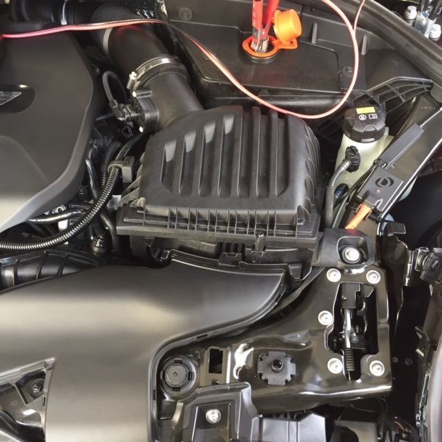

Does anyone have a bit better photo of where they installed the device? Maybe one with the cover removed?
Does this help? Shows where I secured the module.
See posts 53 and 55 on this thread.
