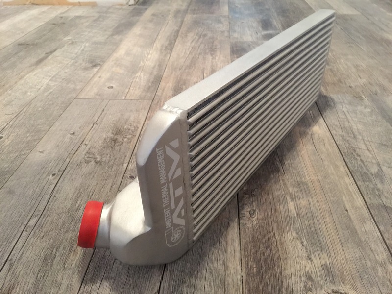

Beat me to it. BTW there is a reason our cores have a blasted (rough) finish. It creates more surface area for a better conductive heat transfer.
