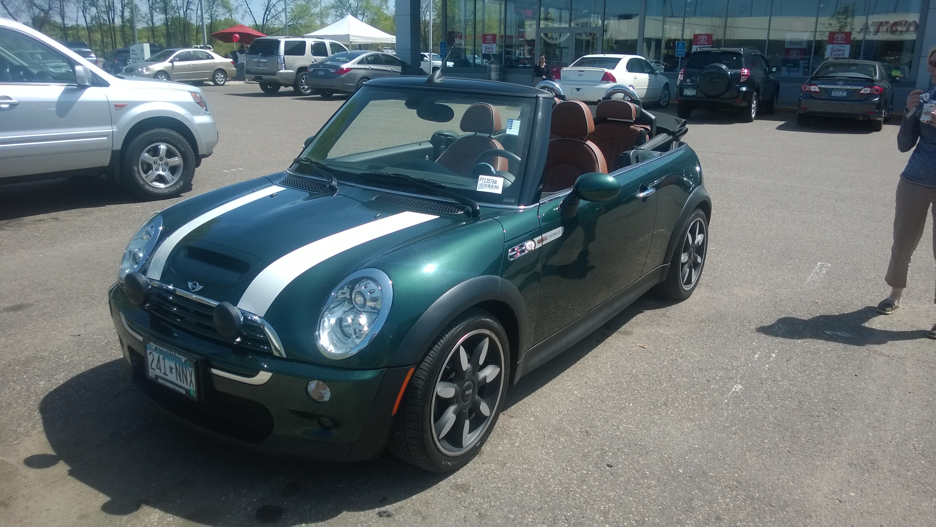

Do I need to replace my belt tensioner?
I have an 07 Sidewalk Cabrio that I'm getting ready to mod. I've already put on the CAI and I have an Alta 17% pulley and new belt. My question is should I replace the Belt Tensioner while adding the pulley? The car has 66,000 miles and is in great shape. Thanks in advance.
