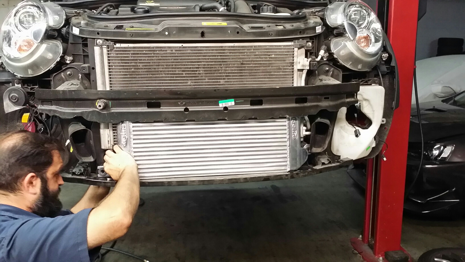

Didn't have to take lower crash bar off. It slide in perfectly. Shoe it in starting from underneath the top crash bar.
Attached Thumbnails Helix | Intercooler Introductory Offer!-20150903_193226.jpg   Helix | Intercooler Introductory Offer!-20150903_192847.jpg

Did you do the install yourself? If so how long did it take you including removing and reinstalling the JCW bumper?
Old Sep 4, 2015 | 07:19 PM
  #108
Ovrclck's Avatar
Ovrclck
Joined: May 2014
Posts: 574
From: Seal Beach, CA
I paid a friend to do it for 100 bucks. Took 1 hr total

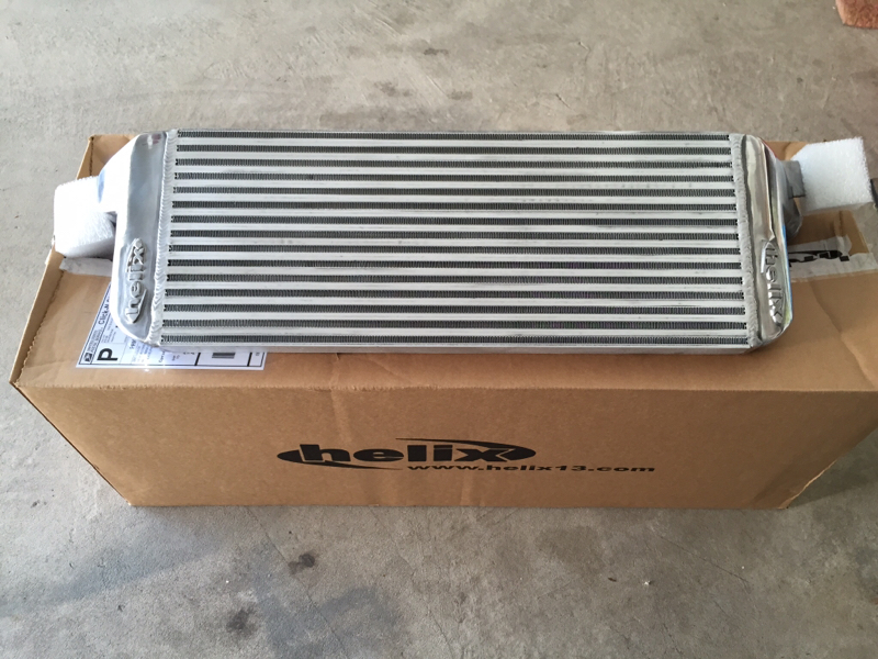

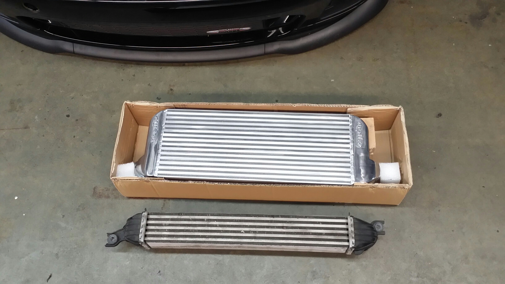

Unpacked my big oh box from HELIX.
and this is what I got. Lots of them.
V
V
V
V
V
V
V
V
V
V
V
V
V
V
NOT !!!!!!!!!!!!
Got one of theses beauties ! And a surprise. But I won't reveal it. You will all have to wait.

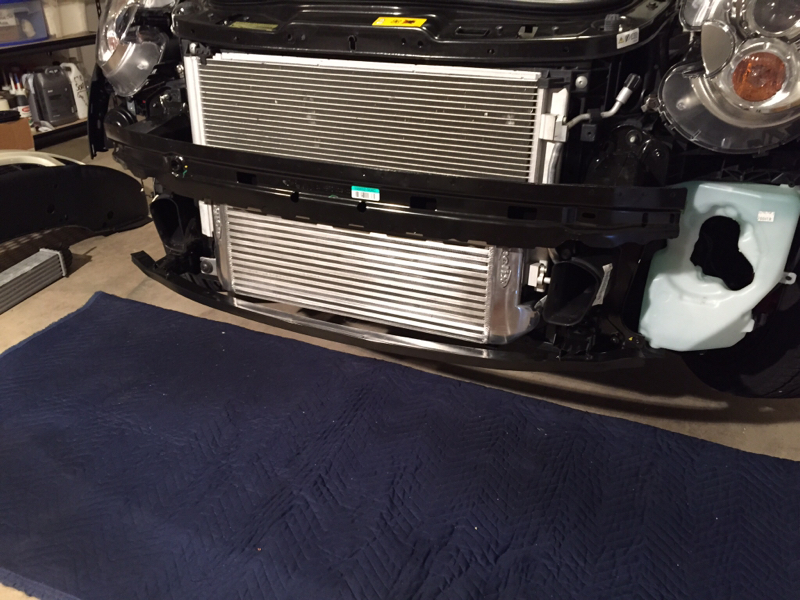

ITS IN.... Woooo.
First class all the way HELIX has a great product here.
A few install notes. The helix YouTube video is GREAT but for JCW and later model owners there are a few more steps.
All of the mounting stuff under the bumper is countersunk so it's not flush mounted like the video
There are 3 additional pain in the *** Philips head push pins that I had to mangle to get out and my car only has 2200 miles on it. Theses three push pins actually support the lower bumper and screw into the bottom of the additional crash bar. Also the bumper support and crash bar have to come off so it's 4 more bolts 6 more nuts and 4 torx screws no big deal at all no issues just unbolt it and put it back the same way.
For those who ask if the crash bar gets in the way. The answer is absolutely no. It gets in the way of installing it but once installed it's far far away.

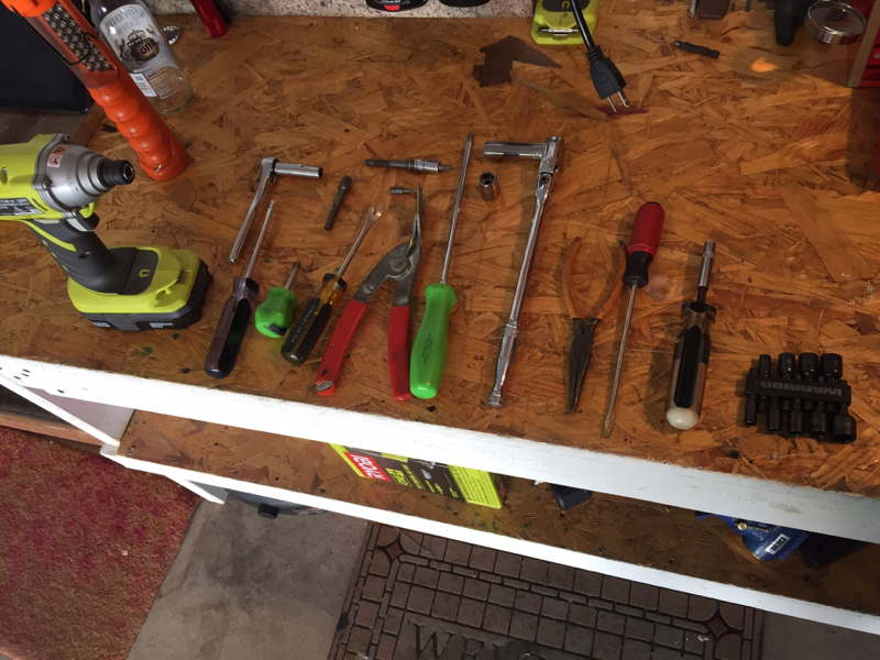

I'm an advanced mechanic but never took the bumper off a MINI. I did it with hand tools and a cordless impact in 2:18 minutes. 5 CORONAS and a little delay dealing with those 3 additional push pins
Getting ready. ( car on jack stands. I did not take wheels off ). Lighting and drop cloth at the ready
Tools used.
Bumper off

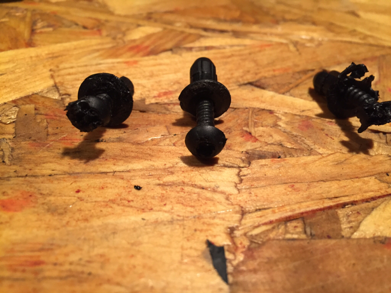

3 push pins from hell. I replaced the plastic Philips center with 3 screws I had. No biggie.

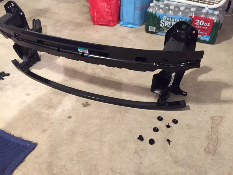

Bumper crash bar removed

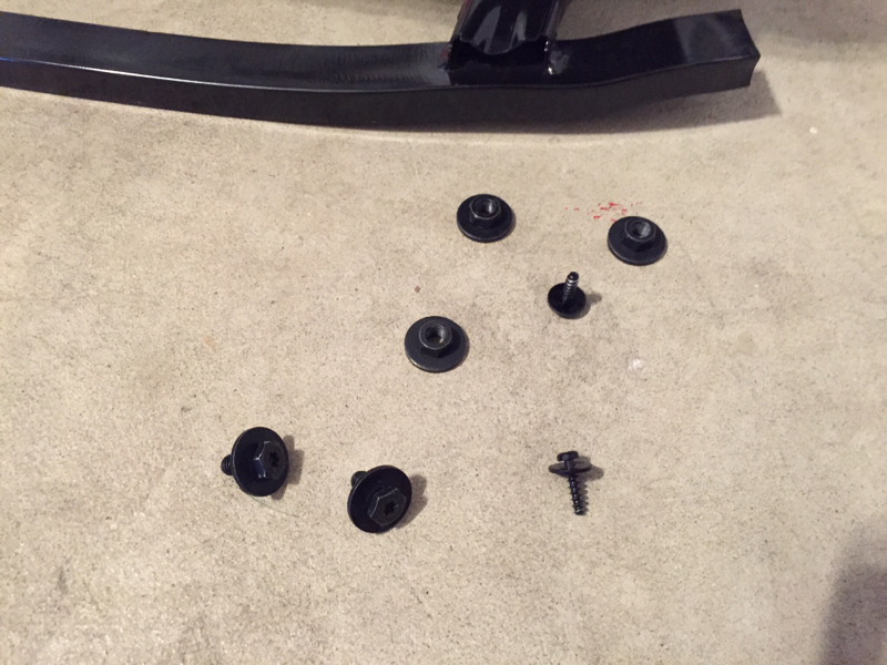

Hardwear for crash bar support.

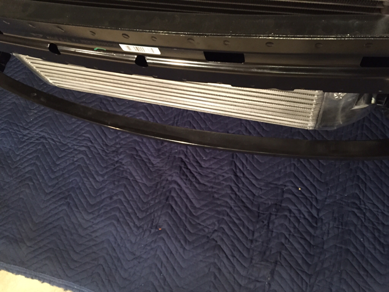

Cooler installed with crash bar back in place
Plenty of room with lower crash bar and cooler installed
And it's all over
Add 1/2 hour for clean up and stepping back to look at your handy work and road test and you are all done !!!!!

I don't bother with those 3 extra Phillips push type fittings anymore.

Yes, the plastic Popit connectors are a huge PITA. They're designed to make assembly more efficient--at the expense of the auto technician. We keep a full inventory of replacements, and if in doubt, we just destroy them off. They also have annoyingly sharp edges that cut up your forearms when working on nearby parts.
