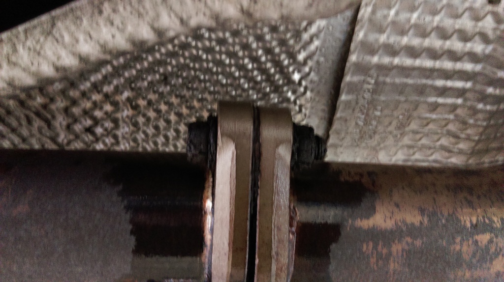

Recently, I learned the bolts for my Invidia N1 catback exhaust had rusted badly and were splitting. I put the exhaust on my '06 MCS back in February 2010, so they were only about five years old. I'm sure the condition of them would be better if I still lived in Virginia, as we rarely had to use road salt during the Winter months. The German road crews lay down a salt mixture even if there is only a bad frost in the mornings. Recently, it was explained this mixture includes animal urine, and this is a major contributing factor to the rusting of parts.
Having looked at the underframe of my MINI previously, I knew some of the bolts had a whitish coating that resists the elements. I did some research and learned that BMW makes Inconel bolts, which contain NiCr, or nickel chromium. Some of the formulas used for Inconel bolts can handle temperatures up to 2000 degrees F and are highly resistant to corrosion. I also learned the nuts are copper coated to help prevent seizing.

Condition of the bolts before I removed them (they appear darker because I had sprayed them with Liquid Wrench to help with getting them off, though most broke):
