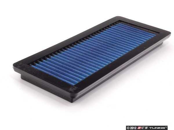

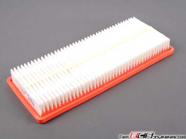

Here is the OEM MINI air filter for the Stock R56 Cooper S, Fits R57 Cooper S Convertibles, R55 Clubman S, and R60 MINI Countryman S/ SX. There are also the aftermarket and performance options. I don't know what they gave you, but sometimes there cross ref system does not show the right models.
Air filter Part # 13717568728
http://www.ecstuning.com/Search/SiteSearch/13717568728/

You are not going to see a filtration or performance increase going to a performance brand filter, I'd get the MINI or MAHLE filter from ECS. Cheaper, good paper filter, flows as well as you're going to need ever.
