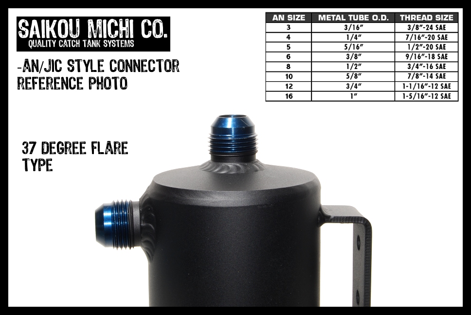

Well Im doing a dual can unit, and having him fit it with AN fittings, should be quite trick. Atleast look cool lol
The PCV will be routed away from the intercooler as I understand and heres an image. Couple of the gurus here been discussing couple other things to make it better.
