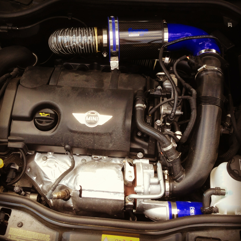

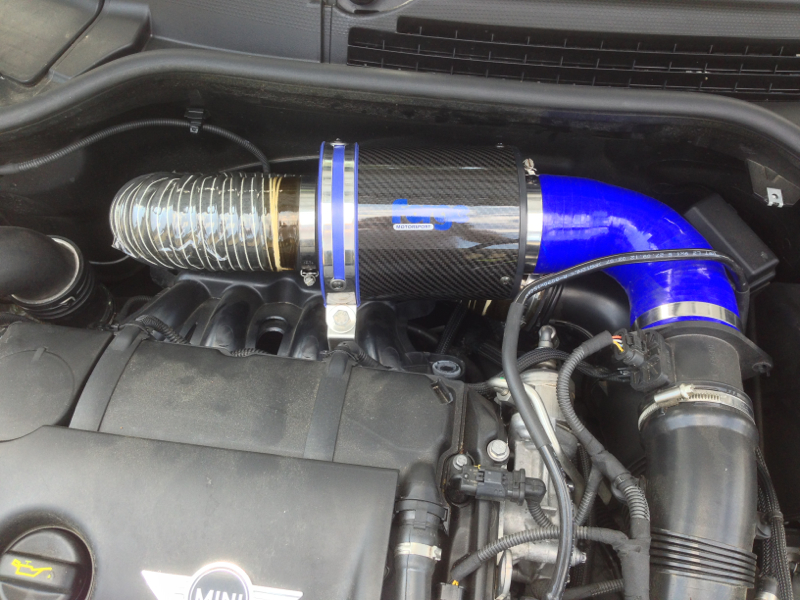

Old Jul 16, 2013 | 05:15 PM
MINImize13's Avatar
MINImize13
Joined: Feb 2013
Posts: 104
From: 18018
Old Jul 16, 2013 | 05:42 PM
NewCooperFanatic's Avatar
NewCooperFanatic
Joined: Jul 2011
Posts: 1,025
From: Los Angeles
Originally Posted by MINImize13
Very cool...I like it. It's way different than what everyone else runs on here.
Any cool noises with it? It looks fairly small!
