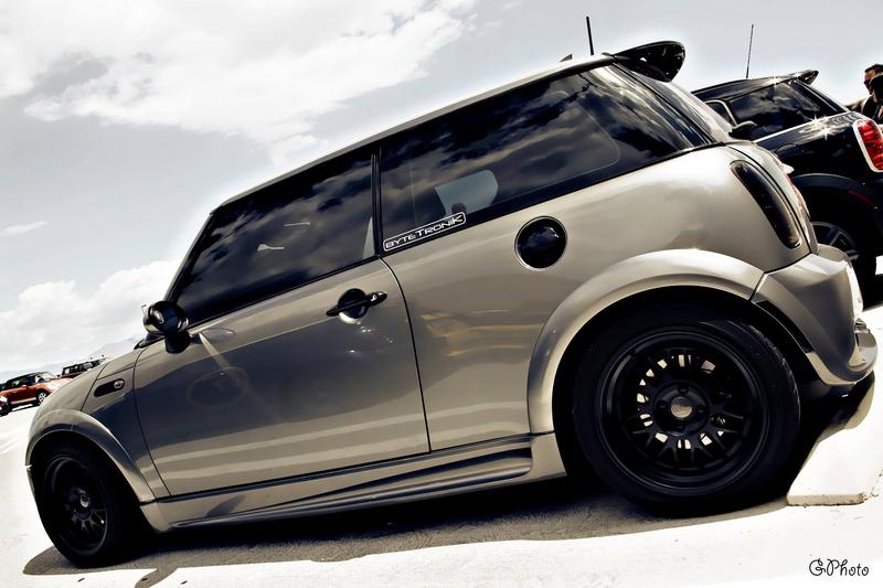

Stance Mindset Wheels. They are 16 x8 et26
I see that you have a GPII, they don't make these wheels in a size 17.
Your larger brake system may not work with these rims. The R53 brake system is smaller
and the calipers just clear.
