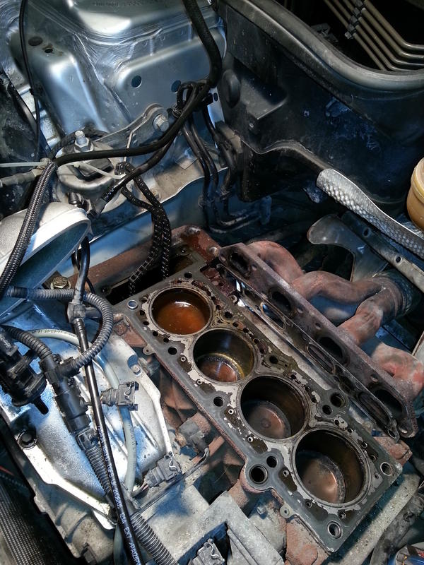

lots of water in cylinders 1 and 2 was found
At least now car is reassembled but when we came to start it up we found a fuel leak
Now we just have to find that LEAK

Fuel Leak, Just check the barb fitting on the fuel rail. I have had them not seat all the way before.
its pretty uncommon to have a bad fuel leak on these cars.
That water falls into the cylinder when removing the head, not when the car is running (or it would stop running in a great hurry). Good luck with your fuel leak.
