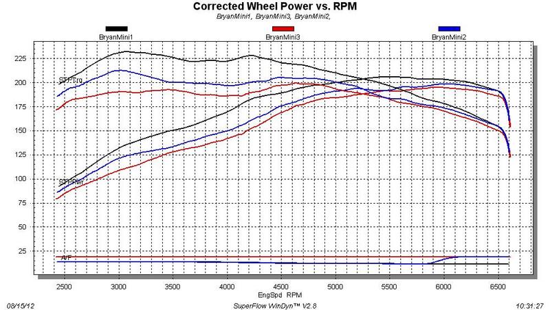

I really appreciate all of your responses. It has taught me a lot and gave me questions to go back to the dyno guy with. As a result the dyno guy did some more analysis/research. I don't understand a lot of what he said, but basically he said my car is fine and that I should cancel my appointment with the dealer.
He said the AFR can jump up when the car is heat soaked and the voltage is applied to ground. The measurements he showed me were for my third (last) pull only...hence the high heat. He said in high heat, they probably disable the closed loop operation of the sensor and just run open loop to get accurate readings. He went back and checked and one other guy's AFR was at 19 on the last pull as well.
It looks like the chart I attached earlier in this thread was comparing my third (worst) pull to Jacque's first (best) pull. I asked him to send me a chart with all three of my pulls, which he did, along with another chart that compares my best pull to Jacque and to Seth. Theirs are both '08's, manuals, but with lots of mods, JCW tuning, etc. I'm attaching those charts here because I am rather pleased with the results.
Thanks again for the input. It has saved me a few hours of driving and waiting around at the shop.
