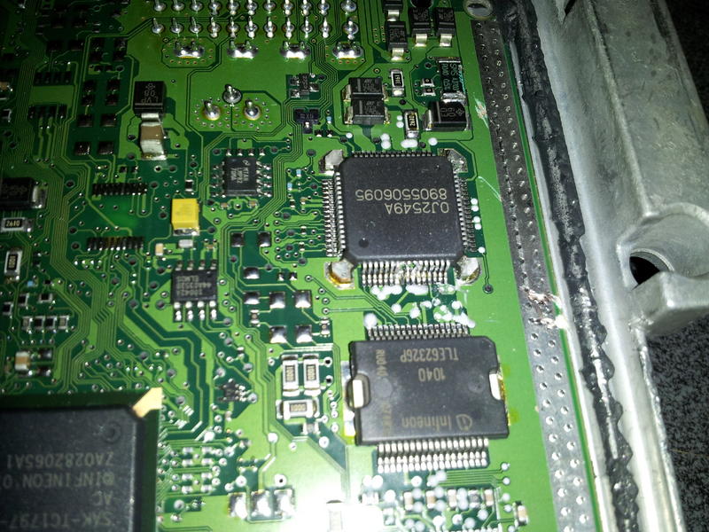

wanna do a little steaming!!! i drove 900 miles round trip to visit jan yesterday to get my issue taken care off, we spend half the day trying to figure out why my car only has 120 hp on the dyno, the computer kept throwing the code diverter valve shortage to ground, even though before coming to him i changed my air diverter valve with a new one from the dealer , he thought it was something wrong with my wiring harness... we ran out of options and told me to go see if the dealer can fix it, the dealer noticed someone was tempering with my dme/ecu and voided the warranty on it, so i took the car back before they void more ****. wasted another 160 bucks at the dealer to tell me what i already know... drove back to town and gave my car to a good bmw / electrical tech i know really well. he opened up the dme and found why im having all thes codes and issues, the tabs or connections are bend on the dme as u can see in the pic. i really dont know what to do right now, based on everyones experienced seems like he was a very good guy to tune the car with, but he damaged my dme/ecu and tuned it anyway thinking my car would work fine??? im so mad/angry atm , i dont know what to do, if my friend wont be able to fix the dme im out another 1k for a new dmw..... i will bring this to his attention now and hope i can get my money back......
Attached Thumbnails having issues with jan/revolution mini-dme-1.jpg

Yikes that's pretty jacked. Like you I've heard good things about his work but this alone spooks me. When you get into tuning, stuff can easily go south and when a warranty is on the line, to me, it's just not worth it.
I would think he should give your money back AND replace what he broke (if he indeed broke it). That's just good business.

WOW, this is messed up . . . on several levels . . . .
I do hope Jan does right by you.

quick update- the tech got the tabs unbent from touching each other, and now the car is alive again like it was before the tune, he still needs a couple days before he will get to sodder the broken ones that he was not able to bend back into place but the majority are ok and not touching so im somewhat happier that at least it looks like i wont need a new dme, i got ahold of jan and he said he will retune it carefully since he uploaded the stock map when i was at his place the other day , and also refund some money back for the trouble. hope this all comes through well, im a bit nervous about sending it there now but i dont think he will screw it up twice, at least i hope.
