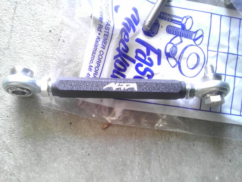

Got the Stiffy. I need to know the sizes of the bolts on the two ends of where the Stiffy goes. I do not have a Bentley Service Manual. My bolts seem to be MIA.
Any feedback would be greatly appreciated.
Old Jul 29, 2012 | 02:22 PM
  #50
feedDunk's Avatar
feedDunk
Joined: Apr 2009
Posts: 25
From: Plainfield, IN
ALTA Stiffy
All done!
What was left of my old dampener was removed.
I didn't lower the motor for install.
I knew i needed both bolts (see previous post for size request) and washers. I ended up using a tap and die set to figure out the sizes needed. Easy after that.
I used 2 Stainless steel 8mm x 1.25 x 1.5 in length, 2 washers to match, and a little blue Locktite. I did remove the passenger wheel and wheel well for easier access and more light. Its a tight fit, but still pretty easy to get in there. Just used an open ended and box 13mm wrench. The instructions provided were self explanatory and simple.
Here are some picts of the part and it installed.
Back on the road!
