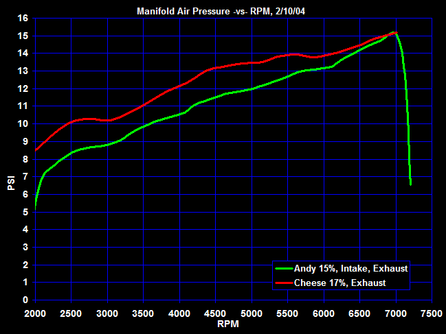

Looks like your intake is robbing some of your extra boost, especially at high rpm.
Important note: The above is an apples-to-cheese comparison.

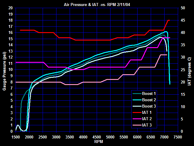

Here's boost and IAT for 3 different runs I did during lunch. All of these are on my car, 15% pulley, intake, exhaust. Ambient air temp was 0 degrees C.

What gear were you in? I'd imagine first would generate the highest temps due to the intercooler getting less cooling air at lower speeds.
And what order where they run? I'd guess they'd get hotter succesively, but you have run 1 listed as the hottest.

All these runs were second gear. Even in the run with the greatest fluctuation in temperature, absolute temp only changed by 4.4% (298K -vs- 311K).

Great - thanks for posting this information!

I just did some more logs as well. It looks like Cheese's 17% has just about the same delta T as my 15%:
Ambient temp was 2 C.

Andy,
Based on your numbers and cheeses (if they are correct), the maximum boost difference is only .5 psi, and the temperature difference is not to far off. Although when cheese temperature drops in relation to yours, the boost drops as well. Very interesting.
Your sampling rate doesn't look so good, compared with cheese, so it is not so accurate. Looks like you may have only taken 13 or 14 datapoints. Is this correct?
I would still like to see an absolute temperature as well. So it looks like the overall boost doesn't affect much and the extra spin is still not putting out much more heat than the 15%. Also, boost is still climbing at 7,000 rpm indicating that the supercharger still has more to give, although the temperatures are starting to overtake it. Now if we can just get a 19%. I think it will show more midrange boost but will still come near 16 or 17psi boost because of temps.

Im not going to mention the apples to oranges comparison again, but does Cheese have an intake, i noticed in your notes, it says just exhaust, just a curious question, and yours does have an intake correct? Are the ambient air the same? I also want to mention since you always attack my findings, i dont think you realize that several factors make my car vary from others, i have done intake modifications, i do use my hood scoops, i do have a moddified head, custom exhaust(header included),diffrent cam(BBR not shrick), different injectors, etc, etc, as you know all these mods play a role in power, as well as the tested variables, simple, better air path can increase the effeciency of the supercharger allowing more boost. I never did say that the boost is what everyone should expect, just that it is what i got......
What are you basing that on? Both my data and that of Cheese, have 27-28 datapoints between 2k and 7k rpm. :???:
Absolute temperatures vary based on driving conditions leading up to the runs. I'll post up a spreadsheet with the raw data and a CFM calculation.
