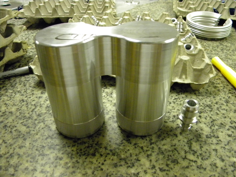

Billet Tech DUAL OCC PROTOTYPE IS IN!!!!!!
After a hot long day today the Billet Technology PROTOTYPE DUAL OCC is in my car for the first set of test on the new mounting point and can set up. WHAT YOU SEE IN THE PIC IS ONLY TO TEST MOUNTING!!! They are working on making new fittings so there will not be and cutting of the pipes at all so what you see in the pics is just a PROTOTYPE and the finished set up will be a very easy clean install for a nice factory finish. (also clear frosted bottoms like the ones installed in my car are an extra option and will not come on the cans unless you upgrade to them on your order cans will come made of all billet as in first pic). Should have something very soon for the N18 as well with 100% fit guaranty.
Let me know what you think, if you have any ideas to make it better or a different idea for mounting let me know as well. As of now it is mounted on a bracket that holds the ABS system (its an open bracket and has 100% no effect on the braking system at ALL!! it just holds the ABS to the wall and is very sturdy.
Here is a link to a youtube vid of the set up
Attached Thumbnails Billet Tech DUAL OCC PROTOTYPE IS IN!!!!!!-dscn1394.jpg   Billet Tech DUAL OCC PROTOTYPE IS IN!!!!!!-dsc_0007.jpg   Billet Tech DUAL OCC PROTOTYPE IS IN!!!!!!-dsc_0009.jpg

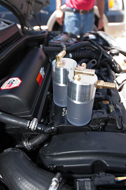

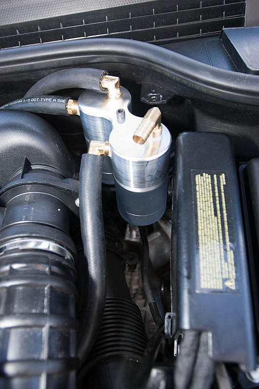

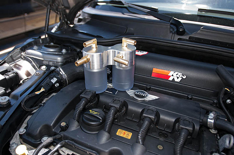

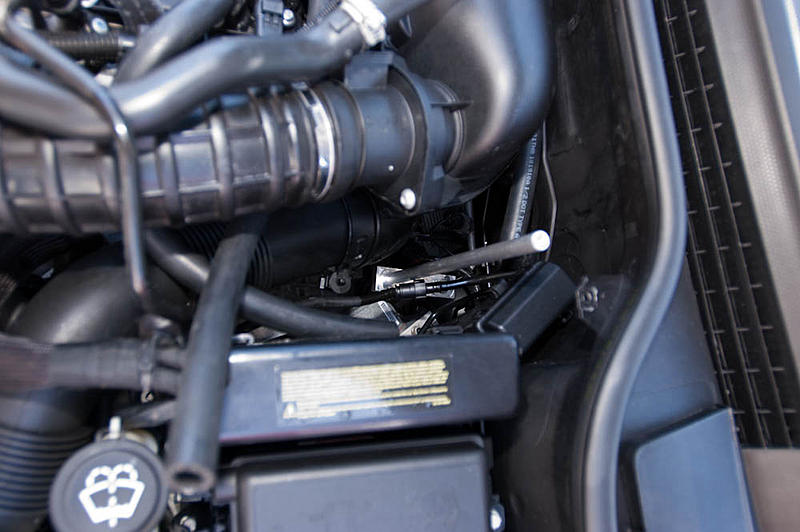

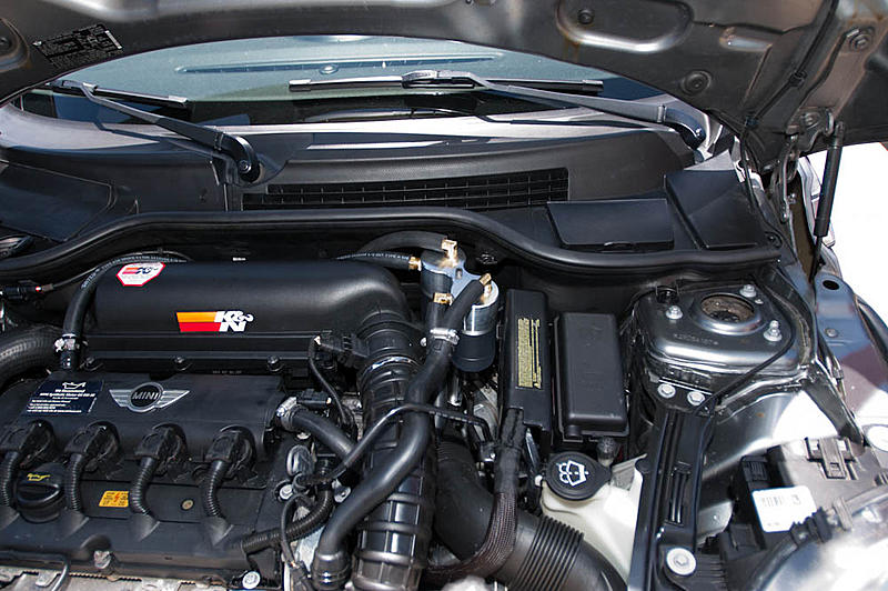

More pics
Attached Thumbnails Billet Tech DUAL OCC PROTOTYPE IS IN!!!!!!-dsc_0018.jpg   Billet Tech DUAL OCC PROTOTYPE IS IN!!!!!!-dsc_0015.jpg   Billet Tech DUAL OCC PROTOTYPE IS IN!!!!!!-dsc_0011.jpg

Thats an interesting and creative way of mounting. How and what on earth is the bracket connected to? It's got to be something metalic. Just drilling into the firewall wouldnt be a good idea

Interesting. What is the holding capacity? Also material of the cup portion?
No drilling at all there is a bracket that holes the brake system down there and it has a hole tapped already on it so we used it. It's very sturdy and mounted to the frame of the car (weight is not an issue) and once the hoses are connected the can does not move!!!

That is a nice setup for a stock car, But anyone with an aftermarket intake might not have the space to mount it there. I know I don't, mine would have to be near the coolant tank and there is no room for a dual can. I actually purchased their single can but returned it because they use 1/2" fittings and really should be using 3/4". The drivers side valve cover fitting is 19mm or 3/4 inch hose would fit directly on it and the intake inlet tube would need a 25mm or 1 inch hose, if they made hose fittings for their can at those size no adapters would be needed or maybe just a 1 inch down to 3/4. They use 3/8npt threads on their Cans and you can't get fittings with 3/4 hose barbs with that thread.
I have no clue what they are made of they make whole cans out of the stuff so when i saw them there i asked if i could have them on the prototype they said yes .(the clear frost is available by special order only and the can make the whole can out of it top and bottom it looks crazy) The really cans are made of billet like the first pic in the OP. (the one on top of the table)
the cans hold 4 oz each it should be enough space to last you from oil change to oil change 3000 - 5000 miles depending on how much oil you car eats up. Since this set up is not blocking the passenger side the OCCs split the catching duty and there is no need for huge cups to hold the oil.
Part of the reason they use 1/2 instead of 3/4 is because PCV hose in 3/4 is hard to find and a ton more expensive they could use other hose that is cheaper but the oil will eat it up and it's just not worth it. As far as flow is concerned the 1/2 inch is more then the car will ever need through those lines.

the dual can setup looks great! i also like the clear frosted cup, but my only reservation about getting those cups is that the insides would get dirty. think they can make a metal cup with a thin frosted section so that you can see how much has been "caught" by the occ?
The cups in the pic are not the ones that come with it and yes they will get very dirty. The way they make the can there is no way to do a peak in but I will pass on the info plus they follow the thread so anything anyone says they read and they look in to it glad you guys are liking the look of it.

Originally Posted by AXO
Just curious why two cups instead of one. Cheers it look very Trick.
It's the best way to 100% know that the cans will not leak pressure. They looked in to doing 2 cans in one that was bigger but there was no way to say that the can would seal right every time so this was the safe way to do it.
Plus now you can take bets with you other Mini friends to see what side fills up faster
