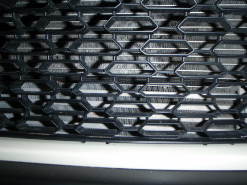

Nice photo of an Alta IC from the front! So what you are saying is that the bottom of the Alta IC is covered by the front bumper, at least 2 inches of it in the area that is fed by the charge pipes?
This is what I see when looking through the front lower grill of my stock 2011 mcs and you can see the different fin density of the IC on the bottom and that is the OEM IC. There must be at least that much below the bumper to be 50% blocked! Amazing!!
Thanks for educating me.

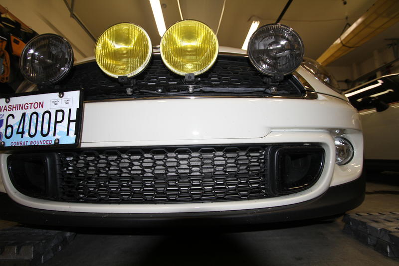

IMO any of these 3 "competing" FMICs are going to be little to no difference. With my "smaller surface area" helix I see 4-5*F above ambient when cruising, 10-13*F when WOT through 2 gears, or, rather 5 below ambient when WOT with meth injection, lol. But regardless, with no additional means of cooling (ie w/m injection), you'll never see below ambient. And while cruising anything under 10*F ambient is more than acceptable imo. Seeing 10-13*F above ambient on a 75*F day while WOT is wayyy better than seeing 140-150*F on the stock fmic. Granted these are street tests, and not endurnace track tests. That encompasses a small % of those here anyways, so take my opinion for a spirited street driver opinion lol.
Having said that, with my grill on, you do not see the "off center" look of the helix through my grill, though, i can't really see the FMIC regardless, so that could be why. JCW aerokit btw.
You can see the size of the stock FMIC compared. Also, the plastic end tanks play a large part in why they heat soak so easily.
Attached Thumbnails Intercooler ???-photo-1.jpg   Intercooler ???-photo-2.jpg   Intercooler ???-photo-3.jpg

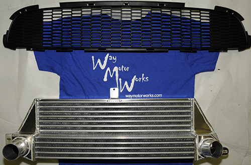

Here are the 3 most popular IC's and how they physically look. I have been trying to figure out what is best to add when the bumper cover is off while installing the IC..Ideas?
Attached Thumbnails Intercooler ???-forge-intercooler.jpg   Intercooler ???-hel_r56_intercooler_md.jpg   Intercooler ???-alta-ic.jpg

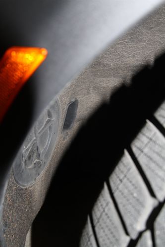

The 2011 Brake ducts look like this. I have a photo of inside the wheelwell & will add to this Post as soon as I can find it! Found it.
