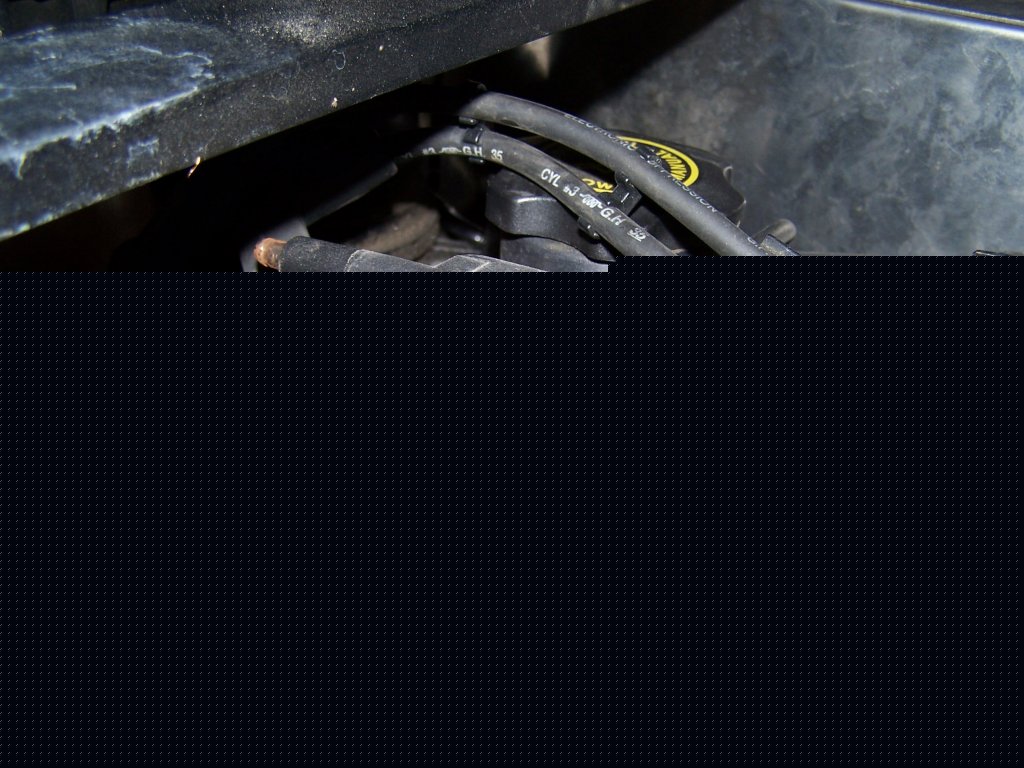

Don't forget the basics. Check your coil terminals to make sure they are not rusty or corroded. #3 terminal is notorious for corrosion. They clean up easily with STP Carb Spray Cleaner and a shop rag and/or a brass brush. Get some terminal grease and put a little inside the spark plug wire boots (you can get small packets at Autozone for like $1).
Here's what mine looked like last summer:

Pull your plugs and inspect them. Normal fuel burn should produce a light to medium brownish-gray color.
