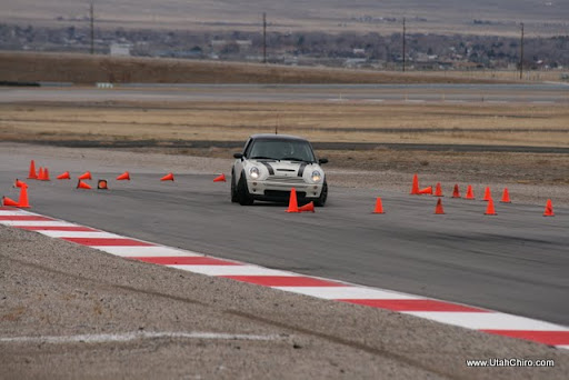

Old Jan 15, 2011 | 09:36 PM
Tanuki's Avatar
Tanuki
Joined: Nov 2010
Posts: 176
So far only the CAI and Exhaust have been installed.
As for today, my second Snowcross of the season.
and
Keep in mind, this is my first FF car ever, AND second time driving competitively. I have only owned it for a bit over a month now? Lost to the other mini with a lot of work done to it by 2 seconds over all. Beat the car that beat me last time by more than 5 seconds!
