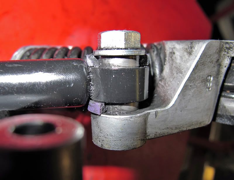

I have a rattle coming from my tensioner dampener due to cracked and damaged bushings. I have the new bushings ordered (Powerflex) but I needed a temporary fix to get rid of the rattle and provide extra safety because this is my daily driver. Here are some pictures of my solution. I used two large zip ties looped around the back of the tensioner bracket and pulling the dampener tight to reduce movement. The fix worked, the rattle is gone and I have some added confidence that it's safe to drive until I get my new bushings.

Nice fix, but you do realize that the damaged damper "bushings" at the ends will not cause any harm. They will only rattle a bit.

The main reason I did this was to minimize the rattle. That was accomplished. I have also heard of the bushings wearing away enough for the dampener to come completly off of one side and come in contact with the crank pulley causing damage. In any case, my powerflex tensioner bushings will be here tomorrow.

Good luck with the Powerflex bushings.

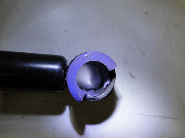

Here's a shot of mine after 12,000 miles.
They were installed along with a brand new tensioner. I still need to contact Powerflex to get their take on it.
Jim
Jim

Wow! Please post here after you speak to them about this. So I guess what you're telling me is that I'm just going to another temporary fix. LOL
That's a bummer. I thought the powerflex would be the last bushings I would have to buy.

Jinz68, I installed the Powerflex tensioner bushings today. They lasted about 50 miles and were torn apart! That sucks!!!
I guess it's time to order a whole new tensioner. How did you fix your situation?

Oh no!! Did you take a photo of the shredded bushing? If so, send it to Powerflex UK. I sent them the photo of mine last night. I'll post their response.
I just sucked it up and bought another OEM tensioner assembly.

Got a response from Powerflex UK:
"Hi Jim,
Many thanks for the picture
It looks like the material hasn’t gone off properly internally. This causes it not to harden and therefore fail prematurely. I can only put this down to a bad mix of material
We now have new measures in place that prevents this
I will get a new set out to you, hopefully I’ll be able to send these by the end of this week as we currently have no stock of this part
Kind Regards
James Bourn ~ Sales Manager
EPTG Ltd
POWERFLEX
7 Union Buildings
Wallingford Road
Uxbridge
UB8 2FR
ENGLAND"
So, it looks like they are aware and on top of the problem.
Not sure if I really want a new set of bushings, though. I'd really like a reimbursement for the money I laid out for a new tensioner and installation.
