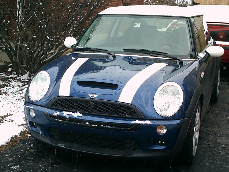

Btw, retro-fitted the Aero spoiler (top&bottom) looks good

Aero grill looks good! Did you have to remove the bumper cover and cut it at all, or did you just modify the grill insert itself?
Old Jan 3, 2011 | 07:52 PM
R53 Speed's Avatar
R53 Speed
Joined: Sep 2009
Posts: 460
Unfortunately you have to do both - You have to shave a good 1/8th inch off all around the grill (while leaving the tabs). Then, you have to cut new slots into the bumper to match the new tabs from the grill.
Takes a few hours of patience but well worth it.
Or, you could cut off the slats of the aero grill and just glue it to the bumper but I do not recommend that - it will be less stable in the end.
