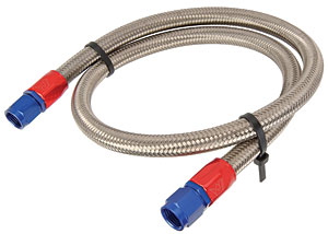

Im doing this set up. Guy builds them to order. Hes going to do An fittings to make it cleaner. Dual cans.
Very reasonably priced. I like supporting artisanal guys.
Ive read to the end of the internet and back, and for our cars based with me being intelligent but hardly the final word Id say dual can is not needed but holds bunch of merit. This car is gonna get mod'd quite a bit. My car does eat oil. A measured cup of oil every 30 days. However the car is mechanically sound, had it gone over and work on it myself.
Attached Thumbnails R56 S PCV System ?-s1-mini-2g-d-install.jpg   R56 S PCV System ?-555-100613.jpg   R56 S PCV System ?-555-111024.jpg
