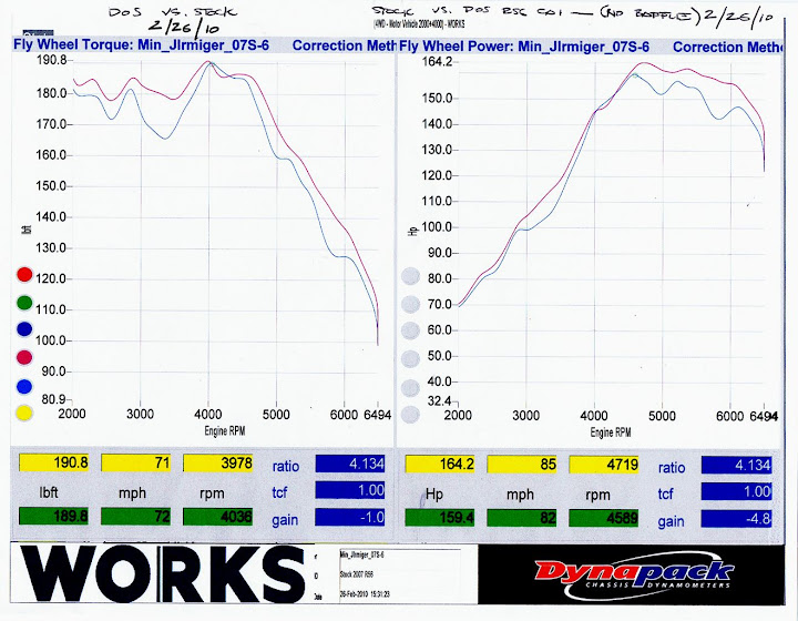

typically speaking, the designs that go into stock manufacturing of an intake system now a days are very high tech and it's almost never necessary to actually change anything except maybe to a K&N filter for more flow. i mean think about it... the stock airbox is used on JCWs and compared to the now R56 (not the refresh) that's a good 40 hp more that the same airbox can support and you never hear of how an intake makes the biggest gains. all the power mods are Intercooler, Exhaust, and a Tune on our cars.
On the flip side, Any intake can be made to make more power, the whole "hot air intake" thing is only really true in stop and go traffic and school zones, above 30 mph there's more than enough air coming in the front of the car to remove all hot air... it's like heating up a house with the windows open in the middle of a blizzard and then deciding to remove one side of the house... Anyway it's true you have to get a tune to get the most out of an intake in most situations. Modifying the stock airbox is usually your best bet.
the pros to having an aftermarket intake is you LOOK more modded, feel more modded, you hear everything so you feel like you have more power cuz you can hear the turbo spool and the recirc valve open. So most intakes without a tune or supporting mods are feel good mods. IMHO i think that my exhaust is my best mod at this point. i love the sounds it makes and once i get a tune i'll think that's the best! if if anything intakes look pretty

Originally Posted by dunphyj
Now for those of you who haven't really seen... the actual gains from an intake on the R56 are pretty minimal…
When you're talking peak torque gains, yes. When you're talking peak Hp torque gains, no.
Originally Posted by onefish2
it is definitely worth it. It's one of the best mods on my car if not THE best.
So, minimal gains, but possibly the best mod on your car…
Originally Posted by fishbert
So, minimal gains, but possibly the best mod on your car… I'm confused.
Is it just the sound that makes it "best"?
As you see in the chart above comparing the DoS CAI with the stock airbox on an R56 MCS (with a stock tune). There are nice Hp and torque gains to be had in the midrange as well as the upper range Hp gains mentioned above. This is the range that we use the most anyway on the street and on club runs.
A CAI (along with a better intercooler and exhaust), can be a great building block toward maximizing the effectiveness of an all-important future ECU tune. Just remember that peak Hp and torque gains aren't squat for everyday fun unless you can also make gains down low as well.
-Clint

Very nice usable gains!
