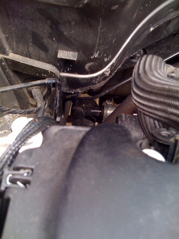

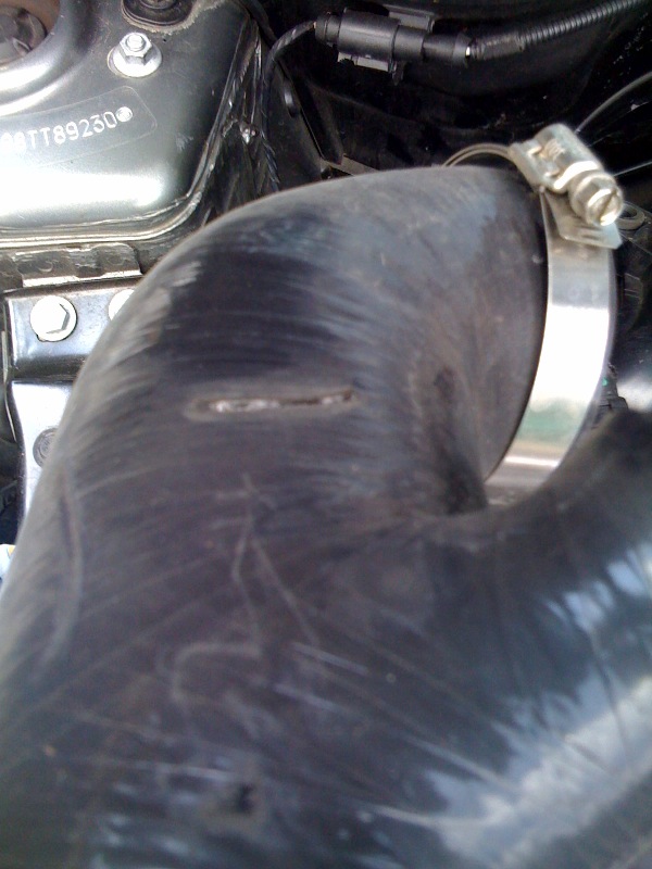

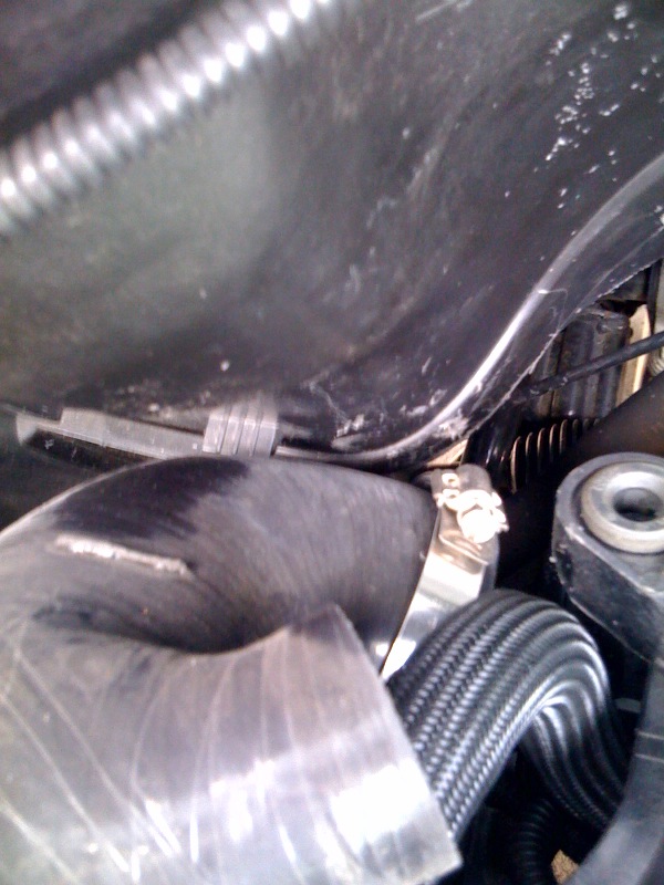

TAKE YOUR ALTA PIPE OFF AND CHECK FOR PENETRATIONS!!!!!!
heres the story. i ordered a BOV from ALTA. When it came, it was easier for me to remove the cold side or trottle body side silicone pipe to install alta bov. When i removed it, i noticed something strange, while engine is heavily rocking, the pipe was scraping on the side of the firewall, and while doing that, the firewall bit into the silicon pipe. here are some photos. inspect your pipe and shave/file down the sharp plastic cast on the firewall.

pipes are fine, its not their fault, its the sharp end on the mini firewall thats biting into the piping, all you have to do it file it down a bit

MiniPOLACK,
In your photographs, can you please put an arrow at the point where it is sharp and cutting the tube.

same thing is happening to mine. We've only noticed it because we had reasons to remove the pipe again. Most people would have no idea it is happening unless it punches through completely and causes a boost leak.

Just took a look at a few R55/R56's here. MAN the JCW R55 has like razor blade sharpness on that spot! A few things to check....
Make sure the top part of the hose is pushed ALL the way forward.
Don't tighten the bottom clamp down before the top.
*If you push the hose on the top and then tighten down the bottom and its a tad close...you can trim up the top mount a bit. We are "right now" adjusting our instructions to reflect the tight tolerance on the firewall. Heck our R56 doesnt have our boost tubes and the OE clamp has made multiple scratches on the firewall.
