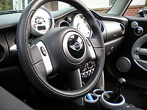

The stock **** fits on, and better than it fits on the stock shifter. much more solid "connection" between the two pieces.
It sits low but not too low. Using a simple unit of measurement:
its about a full shift **** lower than stock. its Perfect. really, haha.
I've noticed the solid bushing make it a bit more noisy than stock, but i will sacrifice that for the super-solid feel.
Here is a great picture of mine with my TWM **** i just got put on:
